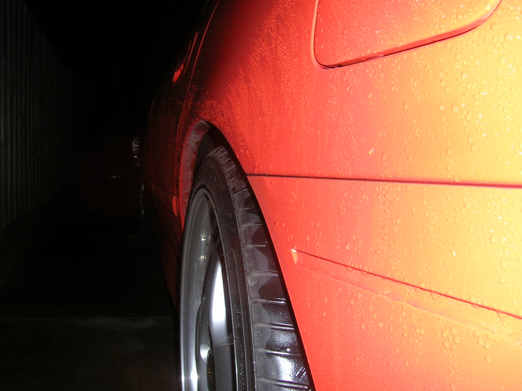

jEtONiT Donating Members 1,817 Member For: 21y 7m 6d Gender: Not Telling Location: next door.. Posted 21/08/05 08:34 AM Share Posted 21/08/05 08:34 AM got 275/30/19 on rear but still cant lower it coz it will rub. had full car the other day and the wheel was hitting the guard. see pic below.anyone got pics of their car lowered on ssl with 275's?cheers. Link to comment https://www.fordxr6turbo.com/forum/topic/19263-superlow-king-springs/page/3/#findComment-285004 Share on other sites More sharing options...

iTec TEAM BA Donating Members 1,755 Member For: 20y 6m 6d Gender: Male Location: North of The Bridge Posted 23/08/05 07:39 PM Share Posted 23/08/05 07:39 PM jetmir said: got 275/30/19 on rear but still cant lower it coz it will rub. had full car the other day and the wheel was hitting the guard. see pic below.anyone got pics of their car lowered on ssl with 275's?cheers.heres some pics of mine http://www.fordxr6turbo.com/forum/index.ph..._album&album=33are you positive it was actually rubbing the tyre? with a full load the tyre travels upward in an arc and therefore slightly pinches in and clears the guard. I have had close to 300kg in the backseat and the tyre went in the arch nowhere near the lip Link to comment https://www.fordxr6turbo.com/forum/topic/19263-superlow-king-springs/page/3/#findComment-286089 Share on other sites More sharing options...
