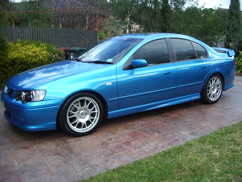

Bain Member 827 Member For: 20y 3m 17d Gender: Male Location: Melbourne Posted 08/08/05 12:13 AM Share Posted 08/08/05 12:13 AM I bought and installed mine on the weekend. (same model numbers)Heres the results. Link to comment https://www.fordxr6turbo.com/forum/topic/19263-superlow-king-springs/#findComment-280025 Share on other sites More sharing options...
