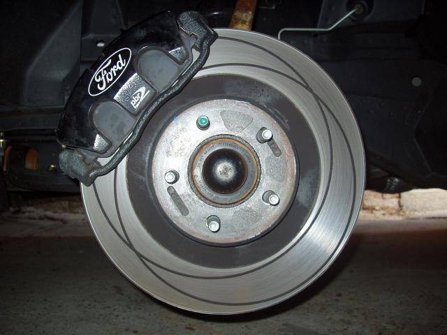

zedman Member 64 Member For: 18y 9m 29d Posted 11/11/06 09:09 AM Share Posted 11/11/06 09:09 AM Has anyone got a pic or the standard calipers and 1 of the premiun calipers so I can see the difference?I bought a T this weeka and the calipers look quite large for standard so I thought it might be the PRB upgraded ones.Any pics would be great.Sooley Link to comment https://www.fordxr6turbo.com/forum/topic/18854-painted-calipers/page/4/#findComment-462952 Share on other sites More sharing options...
aiboart Member 665 Member For: 20y 3m 17d Posted 11/11/06 10:19 AM Share Posted 11/11/06 10:19 AM (edited) Has anyone got a pic or the standard calipers and 1 of the premiun calipers so I can see the difference?I bought a T this weeka and the calipers look quite large for standard so I thought it might be the PRB upgraded ones.Any pics would be great.Sooley←(The picture is copied from another forum members post.)The picture is of the front brake of a BA XRT (BAT) with the factory Premium Brake option.Note the characteristic grooved rotors.The rear rotors have the same grove pattern. The rear calliper is the standard item and remains unpainted.You will have also have a fatory fitted full size alloy spare - mandatory option.Your front wheels will dust up in a couple of days. The PBR's after market upgrade has the same front calliper as the Premiums but in this case it is painted red.The PBR AM upgrade has conventionally grooved discs front and rear. The rear calliper is painted red. (I think) Regards,aa Edited 11/11/06 10:32 AM by aiboart Link to comment https://www.fordxr6turbo.com/forum/topic/18854-painted-calipers/page/4/#findComment-462975 Share on other sites More sharing options...

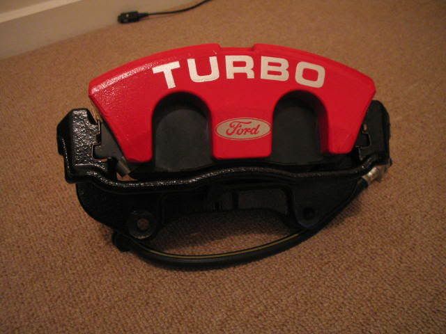

ROLMDL role model Member 1,111 Member For: 19y 1m 23d Gender: Male Location: Melbourne,S.E Posted 11/11/06 10:32 AM Share Posted 11/11/06 10:32 AM (edited) The only differnce between the factory brakes and the premium bakes are* Rear Rotors are slotted* Rear Calipers are just painted that's all* Rear Steel Braided Brake hoses Performance* Front Calipers are still twin piston and painted aswell* Front Calipers have been inproved in bite and design * Front Rotors are slotted* Front Steel Braided brake hoses PerformanceI havent got any pictures of the differnce in the cailpers but.from memory the rear rotors havent changed they are just slotted that's allso that they are still 303 x 16 But the front rotors change and they are bigger they are 325 x 32How do I know all this becuase I work at PBR and I make them PS: these are mine havent put them on but. Edited 11/11/06 10:42 AM by Black ThundeR Link to comment https://www.fordxr6turbo.com/forum/topic/18854-painted-calipers/page/4/#findComment-462980 Share on other sites More sharing options...
