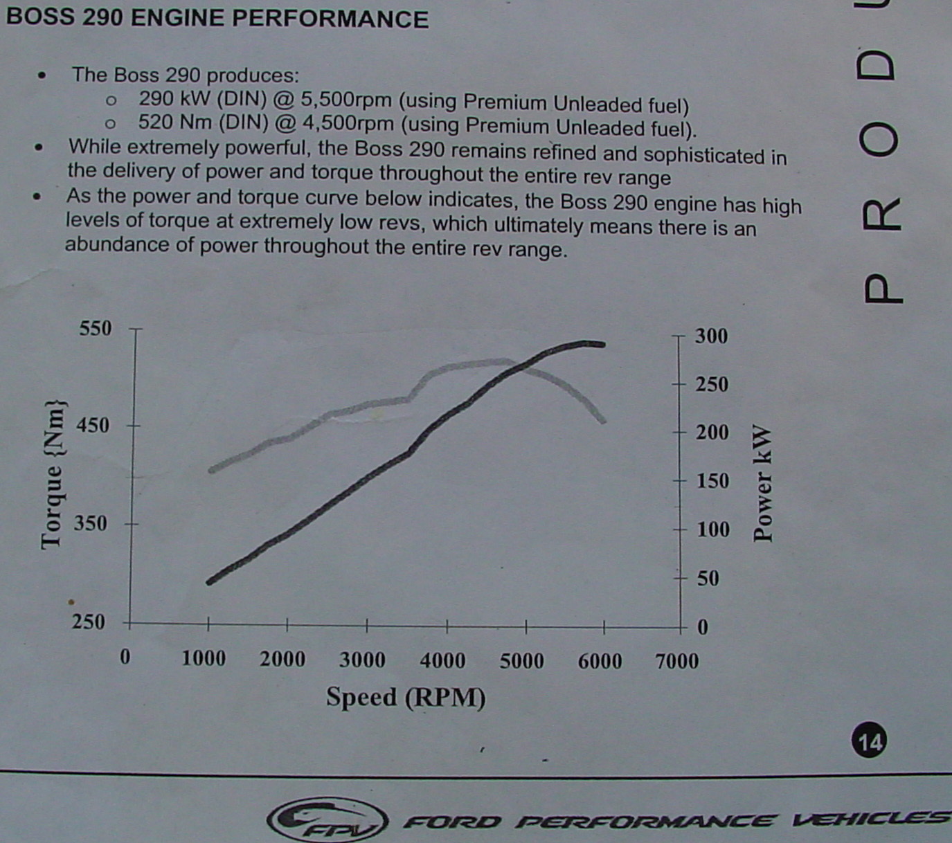

F6_Tornado F6+300+ Member 940 Member For: 20y 4m 29d Location: In The Ute Posted 07/12/04 10:34 AM Share Posted 07/12/04 10:34 AM (edited) For the technical peoples on the site I thought this might help with the F6 numbers.Also the BOSS 290 to compare Edited 07/12/04 10:38 AM by F6_Tornado Link to comment Share on other sites More sharing options...

Venom XR6 Member 1,460 Member For: 21y 11m 11d Location: Geelong Victoria Posted 08/12/04 11:15 AM Share Posted 08/12/04 11:15 AM The stock injectors are holding back the top end of the F6.As for the 290, 400nm at 1000rpm is very impressive, too bad all the torque reduction strategies make it feel like it has about 200nm to protect the driveline. Link to comment Share on other sites More sharing options...
YOOT Member 1,201 Member For: 21y 9m 18d Location: Birkdale Posted 10/12/04 08:05 AM Share Posted 10/12/04 08:05 AM Those FPV graphs are annoying, they are just made in excel. I want to see a REAL dyno graph. Because I know my Turbo's torque curve is quite different to what Ford shows it to be. Link to comment Share on other sites More sharing options...
