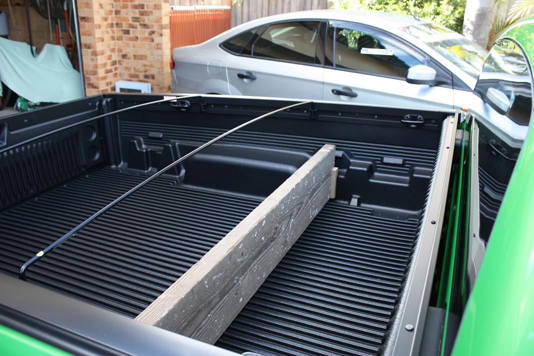

mickgibbo Member 41 Member For: 15y 11m 10d Posted 28/06/09 09:11 AM Share Posted 28/06/09 09:11 AM The slot ford has provided in the tray is 75mm wide which makes it hard to make a lightweight divider (as most people want the divider to be the height of the wheel arch).I managed knocked up a divider this morning in 10mins with materials I had laying around.I used stick of 240 x 45 (10'x2') oregon (old builders plank) as this would be loose in the slots I nailed a small piece of 19mm maple to the end at the slots. To stop the plank rattling I used a very thin wedge.You will notice the base of the slot in the tray has a chaffer, to prevent the plank placing a point load on this little bit plastic a 10mm chaffer was cut to the base of the plank.As the plank was 240 ill prob look at cutting it down to about 5mm above the wheel arches.This solution is a bit rough and quick but does the job. The height is good if you have an esky or items with a high centre of gravity. Link to comment https://www.fordxr6turbo.com/forum/topic/13049-tray-liners-and-dividers/page/3/#findComment-897798 Share on other sites More sharing options...
utemad Member 120 Member For: 17y 1d Posted 28/06/09 10:56 AM Share Posted 28/06/09 10:56 AM This is what I was thinking... ford designed it to be simple and to just use planks.. why make it complicated .. if you want it air fairy cover the plank in carpet.. just remember its a ute not a hatchback before you apply the carpet hey ... heheheeeutemad Link to comment https://www.fordxr6turbo.com/forum/topic/13049-tray-liners-and-dividers/page/3/#findComment-897883 Share on other sites More sharing options...
