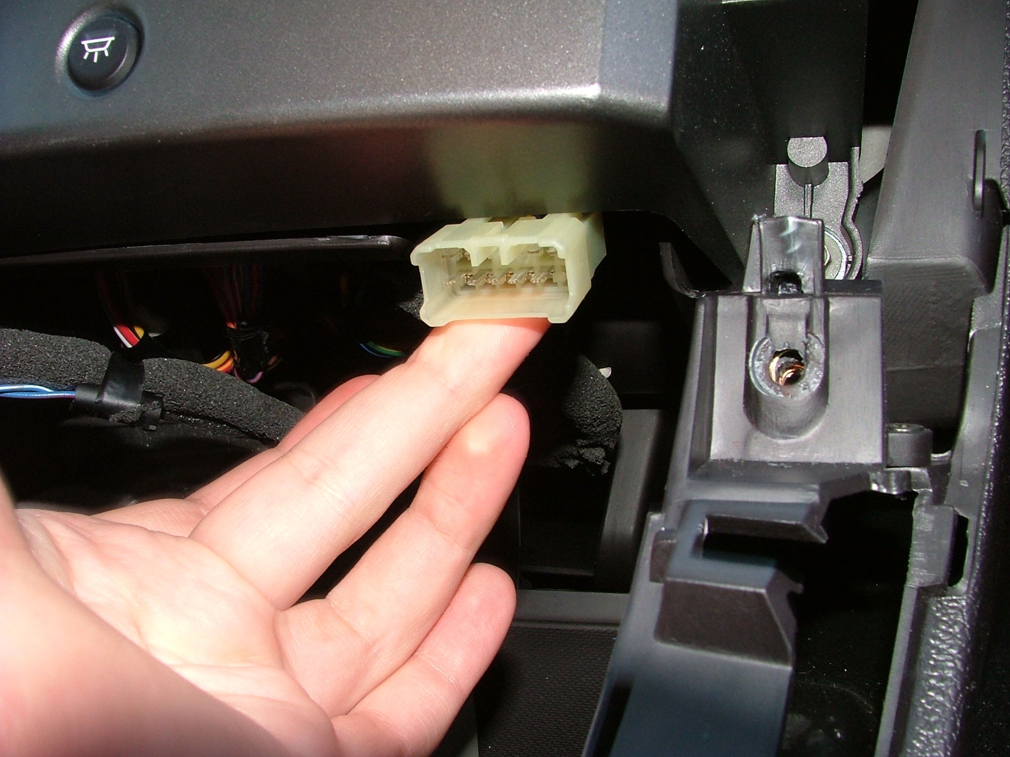

poida97 Member 124 Member For: 21y 3m 20d Location: Bossley Park, NSW Posted 16/09/04 09:37 AM Share Posted 16/09/04 09:37 AM geea said: Thanks guys, I'm learning all the time.Would something like THIS be of any use? I believe that Blaupunkt have a signal converter HERE would they do the same job?Does the Blaupunkt signal converter just plug into the auxillitory plug like a I-Pod?Geea. Nah mate, that thing looks like just a glorified RCA double adapter.That Blau unit is exactly what you're after. Off memory I paid about US$250 including shipping. It is around AU$500 here.I am not quite sure what you mean about the I-Pod - but the IVSC-5501 has 5 video/audio inputs. They consist of four pairs of 3 RCA plugs (1 is for video, the other two are for L/R audio), and a VGA type plug (which has audio built in). It has four composite AV outputs and a VGA output to make five in total. Video sources simply plug in to one side of the unit, and the output lead goes from the other side to the plug under the ICC. Audio does not pass through the IVSC-5501 - it goes directly to the factory AUX input plug.A.. Link to comment https://www.fordxr6turbo.com/forum/topic/12838-dvd-players-with-premium-sound/page/2/#findComment-165883 Share on other sites More sharing options...

poida97 Member 124 Member For: 21y 3m 20d Location: Bossley Park, NSW Posted 16/09/04 10:38 PM Share Posted 16/09/04 10:38 PM Well what it means is that you will need to use the factory aux input, yes. The adapter is $28 from Ford spare parts- or you can make one for much less by following THESE instructions by Aaron.But by the sounds of things it seems like you are already using your AUX input for an I-Pod, correct? If so, you can simply use double adapters to allow both the I-Pod and the DVD player to use the AUX socket.I believe that the 5502 is a newer version of the 5501. I have also been told that the smaller 1- and 3- port 1102 and 3302 will also work - and should be cheaper - but I have not used these. I use the 5501 and it works fine.. Link to comment https://www.fordxr6turbo.com/forum/topic/12838-dvd-players-with-premium-sound/page/2/#findComment-166026 Share on other sites More sharing options...
