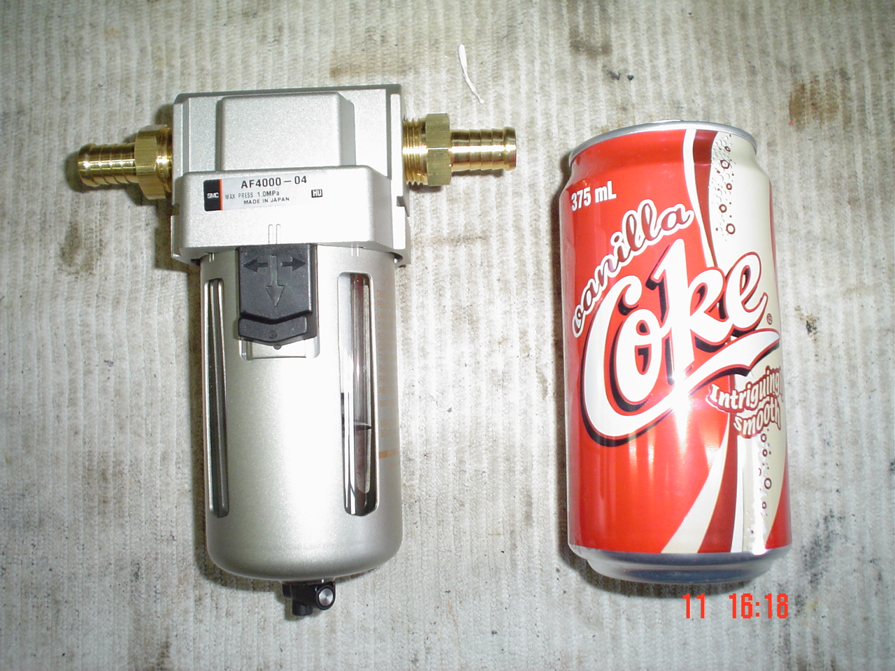

Guest EXR24T Guests Posted 11/08/04 07:03 AM Share Posted 11/08/04 07:03 AM what do you all think of this oil air seperator used on air lines as a possible catch can mod .( it has no air flow restriction at low pressure either !!) . pic 1. Link to comment https://www.fordxr6turbo.com/forum/topic/12199-oil-air-seperator-modification/page/2/#findComment-153413 Share on other sites More sharing options...

Guest EXR24T Guests Posted 11/08/04 07:10 AM Share Posted 11/08/04 07:10 AM cost of oil air seperator aprox $50.00 plus GST . ( not including barb connectors ). pic 3. Link to comment https://www.fordxr6turbo.com/forum/topic/12199-oil-air-seperator-modification/page/2/#findComment-153423 Share on other sites More sharing options...
Blown BA In Your Face Member 6,195 Member For: 22y 1m 17d Gender: Male Location: Peninsula Posted 11/08/04 07:19 AM Share Posted 11/08/04 07:19 AM what do you all think of this oil air seperator used on air lines as a possible catch can mod .( it has no air flow restriction at low pressure either !!) . pic 1. That is what they use on hydrolic presses at my work, are they the same?? Link to comment https://www.fordxr6turbo.com/forum/topic/12199-oil-air-seperator-modification/page/2/#findComment-153433 Share on other sites More sharing options...
Guest EXR24T Guests Posted 11/08/04 11:08 AM Share Posted 11/08/04 11:08 AM G'day Bloan BA , I reackon so brother . we use these on our air lines at work so I say your on the money . one of my concerns with this device is wether it is able to be utilised in the engine bay due to high temp's !! I will make an inquiry with the suppliers in regards to this . will post more info when avaliable ! all the best EXR24T. Link to comment https://www.fordxr6turbo.com/forum/topic/12199-oil-air-seperator-modification/page/2/#findComment-153530 Share on other sites More sharing options...
Guest EXR24T Guests Posted 11/08/04 11:15 AM Share Posted 11/08/04 11:15 AM G'day Blown BA , now that's a bit better, got to forgive me , me's justa simple plummer , oop's there I go again plumber !! all the best EXR24T. Link to comment https://www.fordxr6turbo.com/forum/topic/12199-oil-air-seperator-modification/page/2/#findComment-153533 Share on other sites More sharing options...
Guest Big Mick Guests Posted 11/08/04 09:17 PM Share Posted 11/08/04 09:17 PM Alright, I have connected a fuel filter inline with the breather tube from the rocker cover to the inlet in the crossover as per EXR24T's mod and it is now running as an experiment. I did a number of pressure readings (with the engine at wide open throttle while driving) prior to fitting the filter and then once the filter was installed and there was no noticable difference with the filter in place.I will retest again in a week or so as the filter will surely provide a greater restriction as it does it's job with the oil vapour.Out of interest I reckon the filter was slightly darker in colour just from the testing I did with it.EXR24T, I also thought about the industrial oil/air separators but dismissed them as I thought they would be too expensive and may not work well at our low vacuum levels. A lot of them are designed for compressed air at 600+kPa. It will be interesting to see what you come up with.Mick Link to comment https://www.fordxr6turbo.com/forum/topic/12199-oil-air-seperator-modification/page/2/#findComment-153608 Share on other sites More sharing options...
