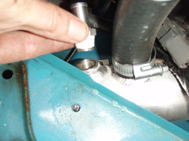

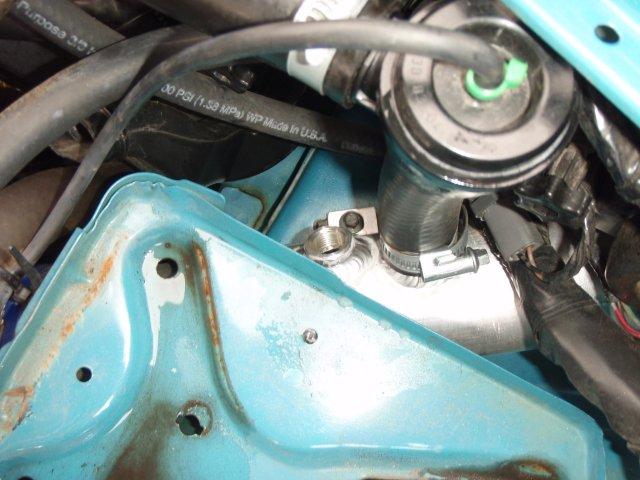

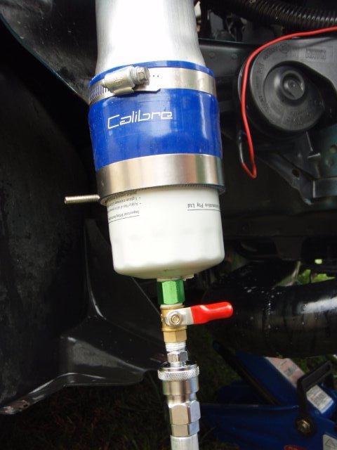

I gathered some parts to get some boost leak testing happening today. I have a very loud whistle/whine sound on spool up which is not from faulty turbo bearings as I have replaced the turbo core recently. So all things point to a boost leak which I suspect is from around the turbo exhaust housing. But I wanted to make sure that the intake was not causing the problem. 1. I got out the air compressor, bought a Ryco 154 oil filter and drilled a hole in the top to which I screwed in an air compressor fitting along with an air tap and using some sikaflex stuck it in so it would be air tight. I hose clamped on a 3" silicone straight hose and then hose clamped that to the under battery intake. YOu don't have to use an oil filter, but it was the right size and all I could find. 2. I then unplugged the breather hose from the rocker cover, shoved a 3/8" socket extension up it and hose clamped it to get it air tight. 3. I bought a can of tuna, undid the inlet from the throttle body, put the tuna can in the silicone inlet and hose clamped it on...made sure to push the can right in there so the strong rim was being clamped down on...the rest of the tin will just crush.....an oil filter of the right size would have been better, approx 80mm...but I couldn't be bothered going back to Supers%^t Auto. In hindsight something more solid like an oil filter would have made a much better plug as I struggled to get a good seal with the tuna can...next time. 4. Turn on compressor, open up the tap on the home made inlet to your boost tester and let about 25-30 psi into the intake system. 5. Listen for a hissing noise...obviously this will be an air leak. Get some soapy water and a spray bottle and spray it on the entire intake....any leaks will start to bubble. You can see the bubbles in the pic below Unfortunately this did not fix my problem, but it did uncover a couple of leaks which should not be there. Since turbo cars have a sealed, pressurised intake system, it should be checked occasionally for leaks. I found one leak in a faulty weld in my intercooler end tank and another in the fitting which screws into the under battery intake which connects to the rocker cover breather. I fixed the breather hose with some teflon tape.

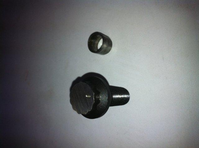

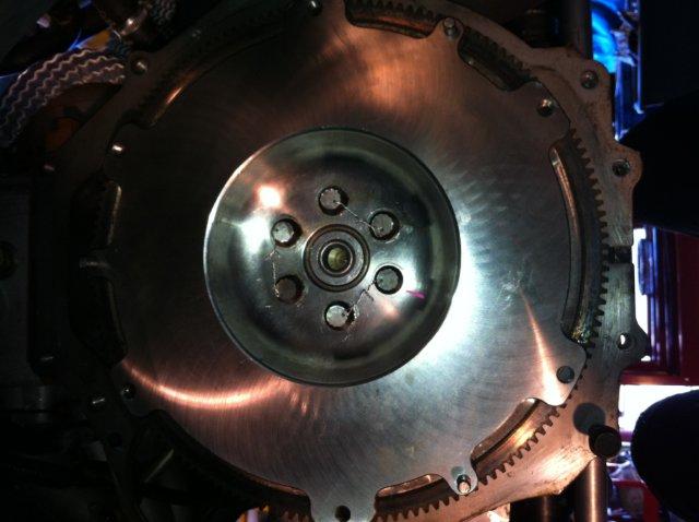

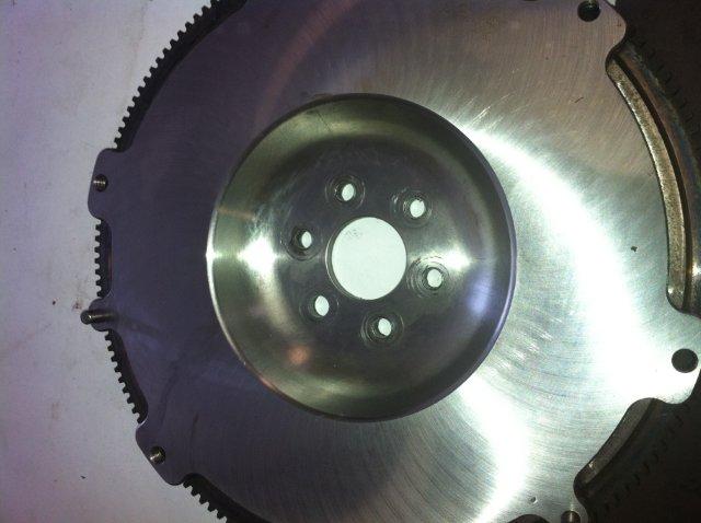

Hi all, I wanted to give Gearbox Logistics in Prestons NSW a plug after giving me some great service and excellent workmanship. I have had flywheel bolts come loose 2 times now due to mechanics not knowing what they are doing. So I start ringing around some local mechanics and transmission shops, I keep hearing, "It can't be the flywheel bolts, just bring it down and we'll pull it apart nad have a look". But could not give me any info on their knowledge of the car or their expertise in the area...just the usual bring it down. So I finally find Gearbox Logistics in Prestons NSW. Speak to the owner Bill and I tell him what I think it is and why and he rattles on for 20 minutes about if it is that how to possibly fix it, his experience etc. Anyway, he comes across as someone with in depth knowledge on the subject so I get the car towed down there. The flywheel needed machining as it was moving around because of lose flywheel bolts, pressure plate and clutch plate stuffed. Mal Wood steps in and I get recoed pressure plate and clutch plate and some great advice. Gearbox Logistics drill in larger 8mm dowels on the flywheel for locating the pressure plate (standard is 5mm) and drill out crank bolt holes on the flywheel as they had been damaged from the movement, they search for some bolts to fit the new sized hole, ended up with a combination of ARP bolts and Volkswagen Golf shanks to fit the new sized holes. Drills holes through the bolt heads and tie wires the bolts on the flywheel together so they can never come loose again. See the pics attached. They even washed the car for me. Their rates are very good and they itemise the invoice so you know exactly what you paid for and how much you paid for it. The car drives better now than it ever has. My flywheel must have been lose for at least a year, a knocking noise that I had in the car which I thought was suspension noise has now gone.... it was actually the noise of the flywheel moving around. I would recommend them to anyone who needs some clutch or manual gearbox work in NSW. I have walked away very happy with their work and level of service.
