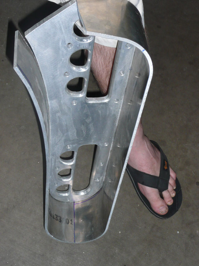

Hi all, thought id post the pics of my work fitting this ebay intercooler and 3 inch piping, please note I fitted 3 inch piping under the battery tray without that stupid battery changeover mod. I did nip a few mm from the front bar reo and also bent the battery tray corner a few mm but no biggies again , thanks to a certain boat builder in mackay for helping me with these mods. now with a plennum and intercooler, 4 inch dump, shes on boost in no time at all
Hi all, I was looking around at all the plennums avail, value for money seemed to be a bit far fetched, I was already in proceeds of making 3 inch piping for intake so I thought I would give a plennum a crack too. thanks to the help of a certain boat repair shop in mackay, here are some pics of my project.
