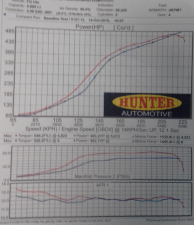

Chose this thread as have very similar setup to OP, although no battery relocate. After spinning the wheels a bit and seeing some high RPM, decided on fitting a new H/D oil pump gear assembly and while in the shop, they put it on the dyno for a quick check over. Due to my ignorance, I was a bit surprised to see 20+psi of boost on the chart. Oil on paper is from originals pump gears I took with me. Car ran a bit rough apparently so plug gaps were checked, so plan is for retune. PSI down a bit, bit more fuel so AFR down a touch and bit more timing as is currently around 5 degrees advance, I think, to extend life of motor. So having NFI, I have a question about the original dyno and current one. HP and torque is similar, but the rpm/power/torque figures seem to have changed somewhat. Origin graph shows spool and max torque about 1000 rpm lower. Any thoughts on any of the above would be gratefully received.

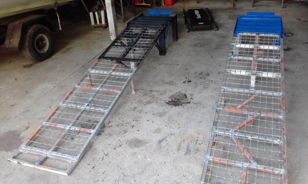

Built some ramps over the past week using scrap scrounged from various sources. Excuse the dodgy paint job. Nice to get under and take a look and get familiar with whats down there. Also checked for any leaks after Atomic oil pump gears fitted.
