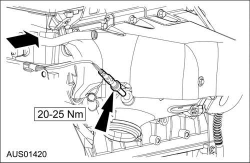

Yep, got the arrow, but I haven't removed the heat shield before. Is the sensor actually on the exhaust manifold?
I need some help changing the oxygen sensor on my 2006 BF XR6T. Please take a look at the attached image and let me know where the sensor is and how I get to it. John
