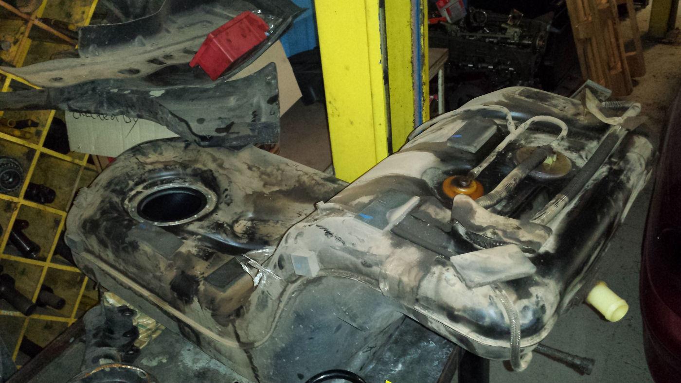

  11. This shows where the pump fits, in the lower part of the tank. Would 1/4 be low enough to take out the pump?
  12. I thought the tank had to be below 1/4 before you could open the tank with out fuel escaping on a sedan?
  13. Thanks. Why does the relay have to be bridged?
  14. I want to replace the fuel pump in my FG XR6T, but the tank is around half full. Is it possible to replace the fuel hose where it comes off the pump with a hose going into a jerry can and use the pump to drain the tank? I don't have time to drive around just to waste fuel. Or is there another way?
