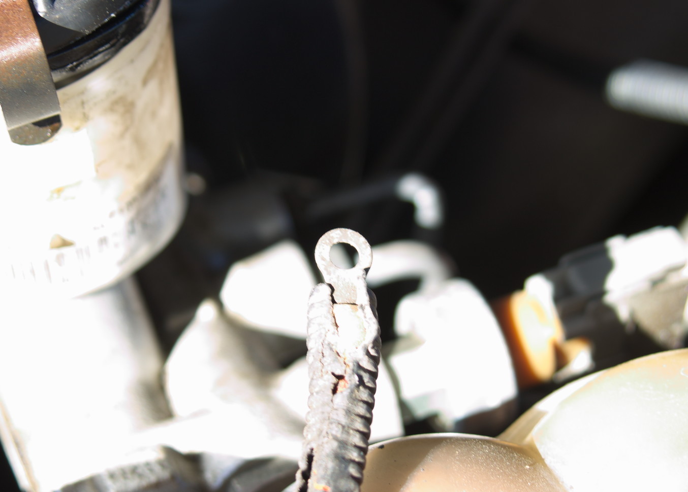

  1. Just wanted to say Thanks to all that helped. I got the Rear Brakes working again. Replaced the Master Cylinder and Booster, and used a compressor to force high air-pressure down the line from the rear end. Mechanic turned up half way through of me using the air-pressure, and he noted that what came out of the lines was built up burnt fluid, which he says isn't surprising if the engine has been given a hard time with high revs, and the extractors would have burnt the fluid in the line most likely where it travels along the firewall behind the engine. I'm going to remove the heat sheild from the headers of the donor car, and put that on the xr6 to at leat reduce some of the heat and so that it's reflected towards the ground more, as per the mechanic's suggestions. I guess you can tell I'm quite chuffed to have the brakes working, especially seing as my wife and kids will be using the car. TF, I didn't have to cut the lines, lol.

  4. Upon looking again, that cable is more like 2 feet long. I drew a red circle in the first photo where the cables comes out of the firewall. I did place a screwdriver to point at the location, but I didn't think it came out too clearly.

  6. While changing the Brake Booster I came across a wire that's not connected and is just laying loose. It has a terminated end to be screwed or bolted somewhere, and is about a foot long from the firewall, where it about 50mm to the right hand side (looking from the front of the car). I can't see where it would have been connected. It looks as though it's been a bit toasty, I'm guessing from the extractors which were fitted before we got the vehicle, and may have been disconnected for a reason. I can fix the wire and put heat shield on it, but have no idea where, or what it's supposed to be doing?
