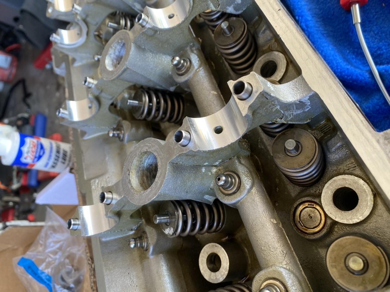

Valve stem sealsValve springs Also the reason I changed cams was the bf gas motor cams and rollers had scorching on them . I also replace with like new rollers ... -

Parts All these parts was from Dominator Motorsport Atomic cams mls 1.3mm head gasket DM head studs DM valve springs DM oil pump gears + backing plate Atomic HD timing chain atomic power str delete Permaseal gasket kit So the engine is in the cleaning process in this pic The block was checked for flatness with a metal ruler all over the deck..I used a sharpening stone to clean the deck with WD40 ...Same procedure was done to the head deck... Then I serviced the head new valve stem seals before the valves was installed...Oil pump gears was also built ... -

Update: I have ordered the Tuff mount kit , We are just waiting on the sway bar...I opened the rocker cover to find scorching on the cams an rollers... So I sourced some immaculate rollers , I ordered Stg 2 Atomic cams ....I also have ordered all my parts from Dominator I highly recommend Michael is a great bloke to deal with an he saved me $$$$.... So I have Dominator valve springs, billet oil pump gears with backing plate , headstuds & valve tool... also Dominator deals Atomic so got my cams for $855 , I’ve also got atomic HD timing chain an atomic power steer delete...Dominator also helped me with a full gasket kit a MLS 4layer 1.3mm head gasket to a new water pump ...So big shoutout to Michael DOMINATOR MOTORSPORT ❤️ I also have a plazmaman intercooler and I have a 12psi turbosmart accuator on its way ... So I have also ported the flapper hole on the Garrett to help hold boost a bit better I hope... So I’m waiting to receive all of the parts to start piecing it all together fun times ahead.... I have also made contact with Bill Hooton for the electrical side of the build he makes the stand alone looms for all conversions again great bloke to speak to and a gentle man willing to help with questions.... I will take some pics very soon -
