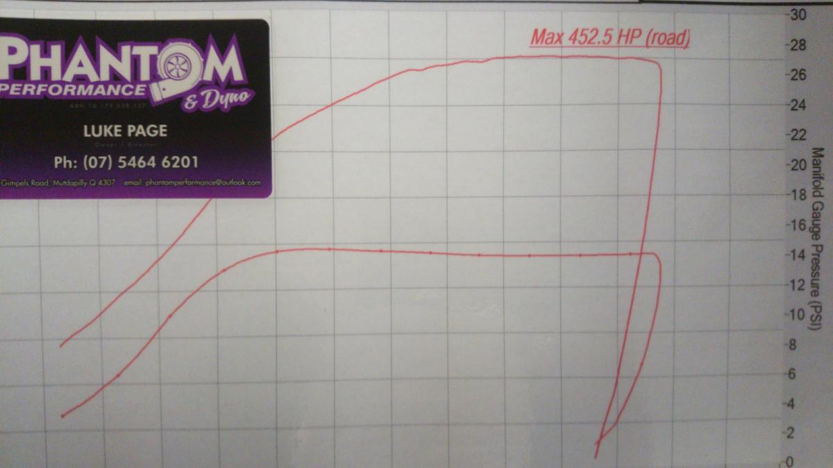

Just got injectors and pump installed, and a tune. Very happy with the car now, completely different to drive :D Some info/pics here: http://www.modifiedstreetcars.com/cars/ford-falcon-mark
