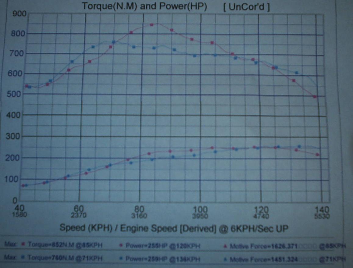

  14. Hey guys, Once again put my car on the dyno to check why its not making much power... The tuner said once again its because of the exhaust, but I seem to think this is not the case. I have posted a sheet of with the edit and eithout. Light Blue being without ( which made more power ??? 259HP) and red being with the 10psi tune ( more torque less power 255HP) Have a look guys and let me know what you think. Thanks Craig

    I also went to BRISBANE TUNING & TURBO CENTRE and paid 260$ and got them to do a diagnosis to find out why it was not making much power. They found a slight boost leak from the turbo to the TB. Then they did the final dyno and it made 184rwkw. They said this is normal and when I changed the exhaust I would notice a bigger power increase. I did mention to him that I thought these made about that stock so it should be even more with the capa edit. He told me that wasn’t true. What should I do? Craig

    here is the full dyno what you guys think is the problem? craig

    yes but that is the one that made 184 and the one that you said the AFR is sh*t is from one today that made 246HP which works to be 183kw
