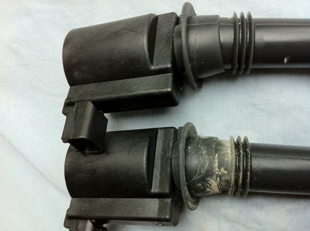

  1. I swapped the white residue one out with a spare coil and the problem cleared up. Just out of curiosity, if the residue isn't due to arcing, what else could it be? Just wondering if I have another problem perhaps brewing. The residue is only on that cylinder (#5).
  2. I have some spare coils, so I'll swap with one of them. Just wanted to check on others who have had arcing and if the white residue in that particular spot is what they've also encountered? It is really high up on he coil... I would have expected it to arc out down the bottom.
  3. Hi All, My car is running badly above 4000rpm, missing like hell. In the pictures attached I've placed what I suspect is a good coil and a bad coil(white residue?). Can you guys confirm? Only changed all the coils about 5000kms ago, which is why I want to check... Cheers
  4. Regapped to 1mm and misfire is gone. Cheers for the help
  5. I'm gonna regap them to 1 and give that a go. Cheers.
  6. I have a stock BA I XR6T with 75k on the clock and very recently the car was misfiring badly when it reached 2500rpm... I changed plugs and gapped them to 0.8. This fixed the misfire at 2500rpm but then started missing slightly on idle. It's irregular and doesn't happen all the time, just a slight miss every so often when waiting at the lights. I changed all 6 coil packs thinking that it's a dodgy coil(had a Ford tech show me that cyl 2 had the misfire on it initially when diagnosing the miss at 2500rpm), but replacing the coils seemed to have done nothing I have cleaned the throttle body and it's idling smoother but still missing. Anyone got any ideas? Cheers
