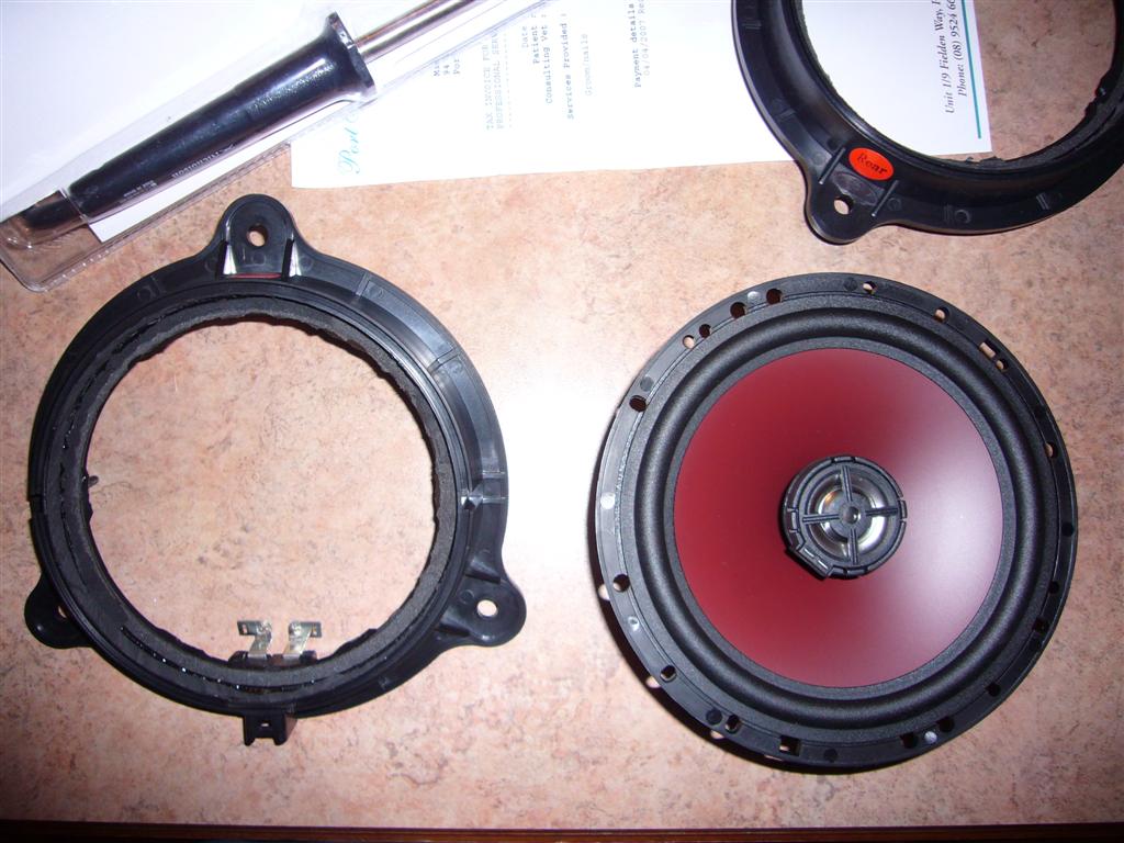

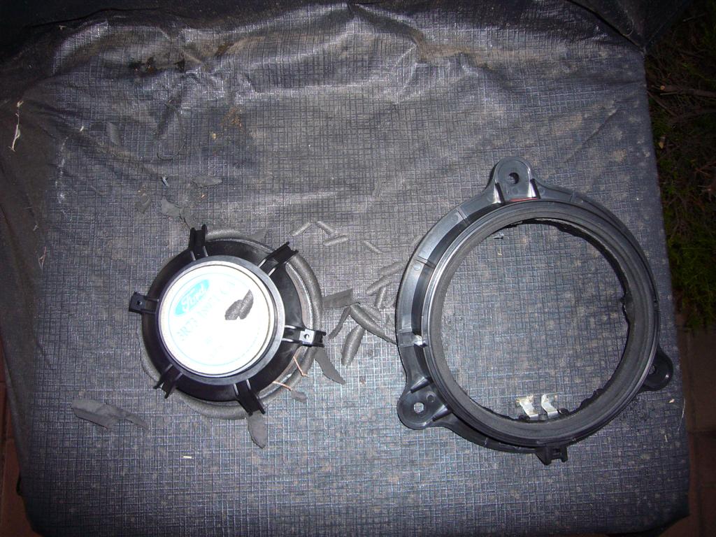

  5. Hi guys just thought I would post this as no one has posted changing the speakers in a terri I decieced to buy some MB Quartz . Spilts for the front and 2-Ways for the rear.Here is a qiuck basic guide. First step was to remove the factory speaker from the housing I just used side cutters to cut it away. I then hot clued the MB Q into the factory housing Next step was solder the speaker wire to the factory conections on the speaker frame . Then last thing was install the modifyed speaker frame back in the door and connect the factory connection. Haven't done the fronts yet but here are some pics of the install on the rears . Cheers Envi_XR8
