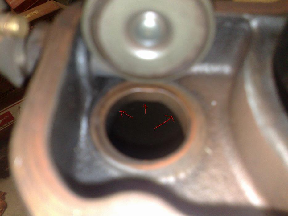

When I initially got my wastegate port done, I was quoted from $250 to $550. I elected not to mention I was quoted that little back at the time I posted that. And no, I did not take the $250 option. Then I purchased the complete Nizpro Plenum/Cooler/Airbox/Battery Kit from you Simon, and immediately on fitting the kit, I found I had over boosting problems. I was unable to bring boost under 17psi. You probably recall the conversation we had, back when you were still doing your wastegate ports with a die grinder prior to getting them done by CNC. You mentioned there is a lot more to it than making the hole bigger, and to focus some attention to profiling from the flange to the flap to encourage flow from the exhaust manifold to the wastegate port. This is when I took it upon myself to report the wastegate myself. This is my result. Commanding 0 Duty cycle in open loop, I can get a stable 12psi, Remembering, I also have a full exhaust with a 4" dump pipe to stir things up a little further. This below is the standard port. Look closely where the RED arrows are pointing, this is the part of the housing that has alot of profiling done. I agree not all jobs are the same, and some will most likely still overboost. Now coming from an Aerospace engineering side of things, I see design to manufacturing every day at work, and a number of years ago, I also worked in an engineering shop decked out with a number of Okuma Lathes, Mills and a Siemens 5 axis machine. A Mill will only be able to bore a bigger hole, and Re-seat the port, it will be unable to get in the housing to do the profiling. This is where you need a 5 axis machine to do the port for you. Knowing the implications of having to model an exhaust housing into a CAD package such as Catia, and then designing your modifications to the port, it only leaves manual programming in M or G-Code for instance. I would love to see the MCode or GCode programming involved to put the level of detail into the profiling of the port as one could do by hand with a die grinder.

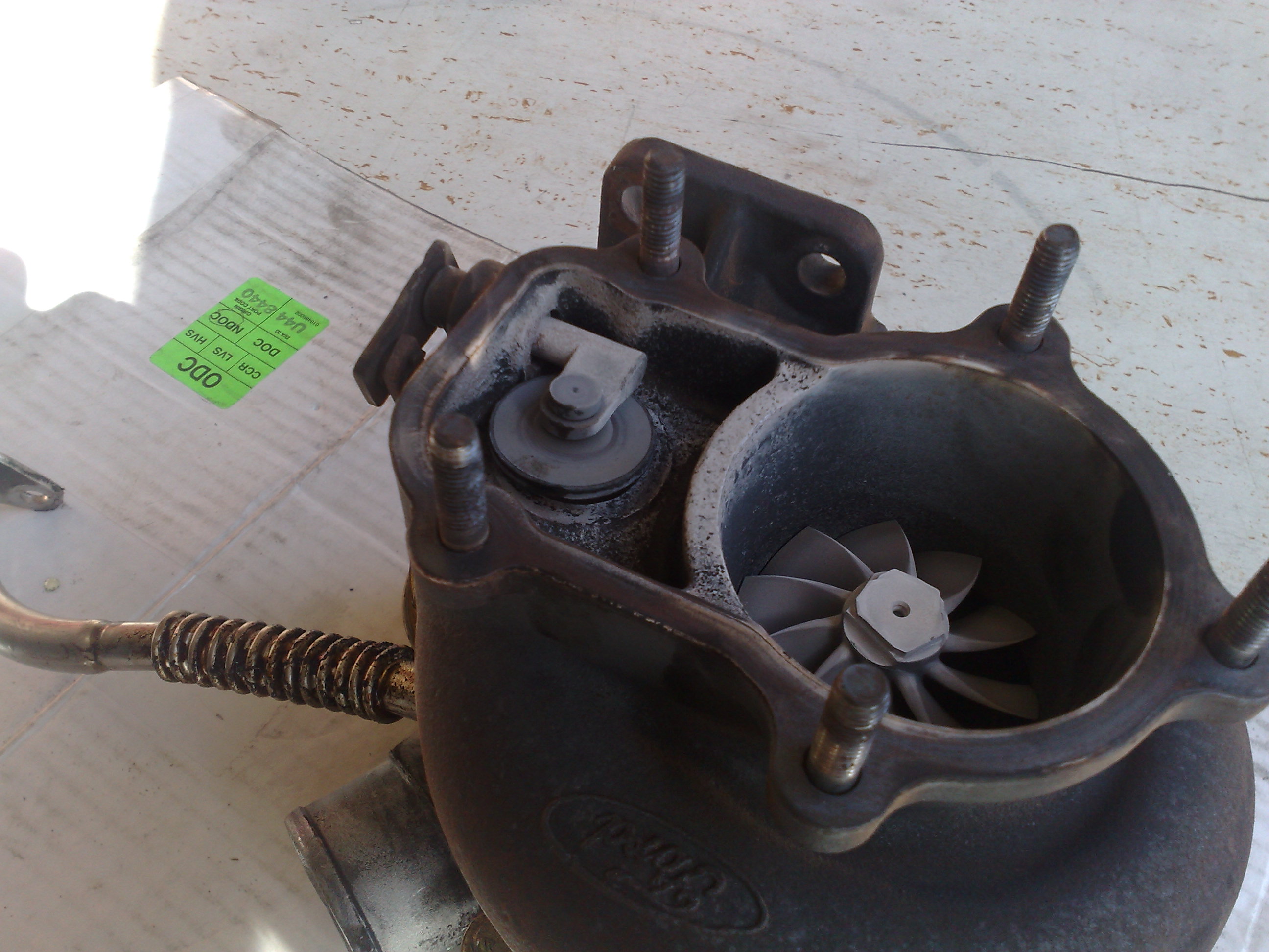

I know what your problem is and its not valve springs.. I've seen 3 cases of it.. 1) Kissy's car, His actuator was disconnected. Somehow we suspect the previous owner, returning the car to stock swapped the actuator and didnt hook the old one up properly. He has been running the capa generic tune, and although noticing a power increase when using the box, vs standard, and a boost increase, this is caused by extra timing.. Remember, his wastegate was not connected, it was flapping freely 2) BB's ute. His wastegate was Jammed open. As you will see in a moment, There is a collet which is welded to the exhaust housing, which has cracked, and slipped outwards of the housing, and the flaps jammed against the side of the housing unable to close.. BB was running a generic tune, his mates said his was real slow on coming on boost.. No doubt, the wastegate was jammed open, there was pretty much NO movement in his wastegate what so ever 3) hqracer's ute. (PICTURE ATTACHED), is also another case where the collets weld to the housing has broken, and as you can see in the picture, the flap is not seating. I tuned hqracers ute about 6 months ago, However, I was rather disapointed with the results on how it come on power. I told him, wastegate actuator, and valve springs.. We choose to do wastegate first.. and good enough we did, because this is what we found.. Here's HQracers turbo as removed from his car. as you can see the actuator arm is still attached, and the wastegate is not shut. the collet weld had broken. Danny -
