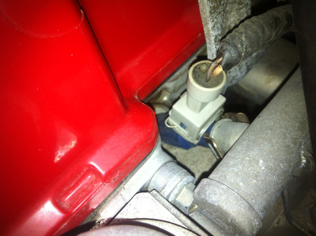

Nah mate wouldn't have a clue hey. Ill be looking for someone around Newcastle after I do a few things to it to get retuned. Found out the injectors are blue Bosch 27lb injectors which really surprises me because of the power difference between stock and the 10psi tune. Think an upgrade may be in order. I thought they came with bigger injectors when there stock -
I actually just googled the part number and they came up as Bosch 27lb now still being new to fords, didn't they come out with bigger injectors then that
Hi guys I've not long got a ba xr6t after owning holdens all my life and want to start doing a few more mods to it. It's flashtuned with a twin mandrel exhaust I've found so far. I'm looking to upgrade the valve springs, chuck a bigger intercooler and fuel pump in. Was going to change the injectors as well but because I'm not sure what's been done I thought I'd put a pic up to see if anyone knows what they are. Sorry not the best pic but thought you would get an idea. They are blue but not sure how else you can tell what they are
