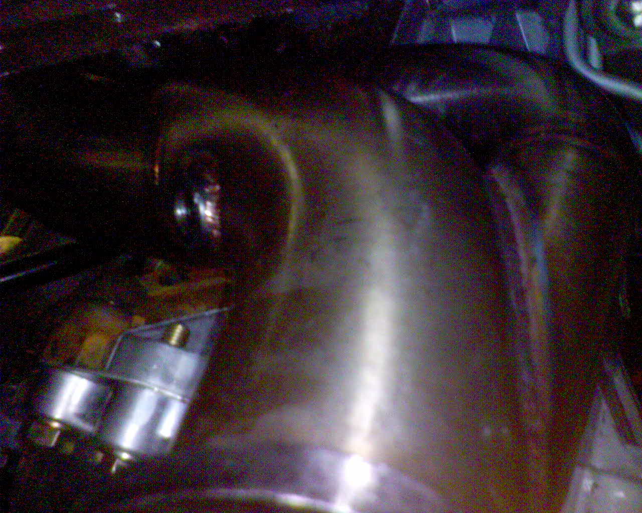

What else have you added to get the extra kw's? <{POST_SNAPBACK}> Hi Flukeyluke, mods are edit, 2nd ci, valve springs, 968's, hiflow cat 3.5inch, ase ic, 3.5 dump pipe and 1 inch waste gate. see attacment for pic hope this helps

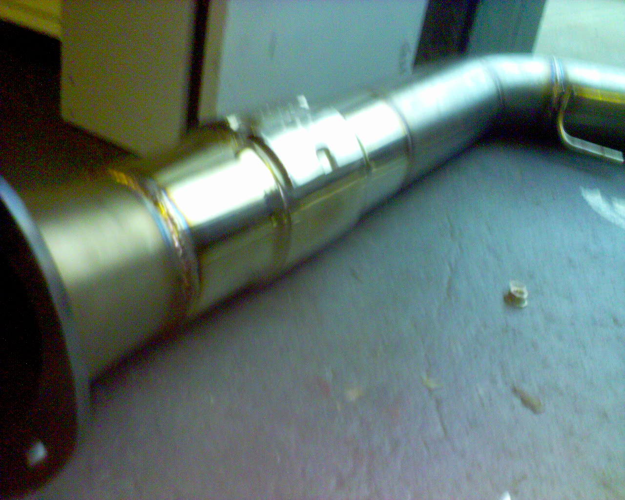

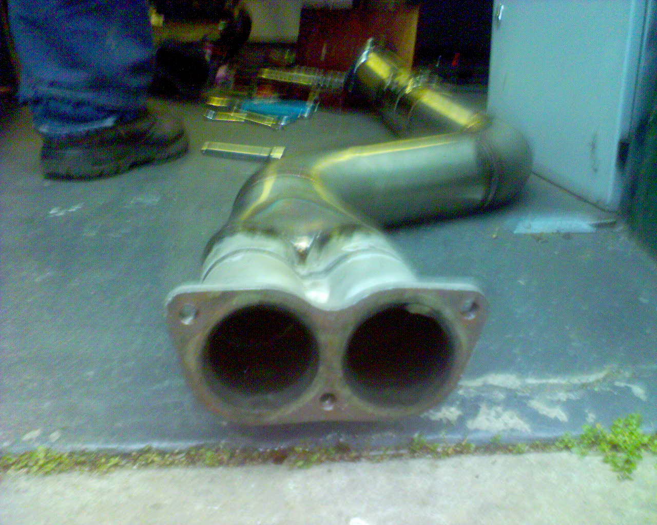

Hi Everyone, Well I fitted the ase ic the other week and the dump 3.5in waste gate 1.inch and 3.5 met cat as seen pictures below the dump pipe and cat made boost peak to 18psi not good, well it booked it in to nizpro for a retune not the best day to dyno car 32degrees very hot. Well peak power was 305rwkws with sligth pinping end result 295rwkws just to be safe boosted at 14psi. Maybe if it was cooler the results would have been interesting. Well Dave at nizpro said the ic dealt heat soak OK and better than standard ic, so if ase can build ic that can handle 32degree heat I'm pretty happy with that. Mod's to car 2nd cai, edit, 968, valve springs,ic,dump pipe and cat. The only weakness is the standard ic pumping. with shorting plumping results would be better more responsive. The standard clutch is fine at the moment. sorry the photo quality was from my camera phone cheers George
