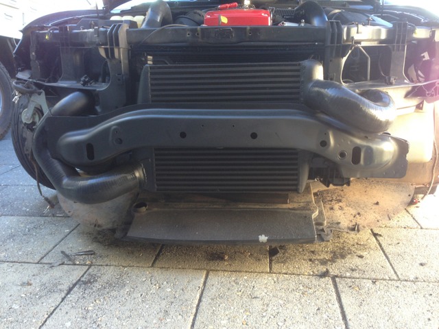

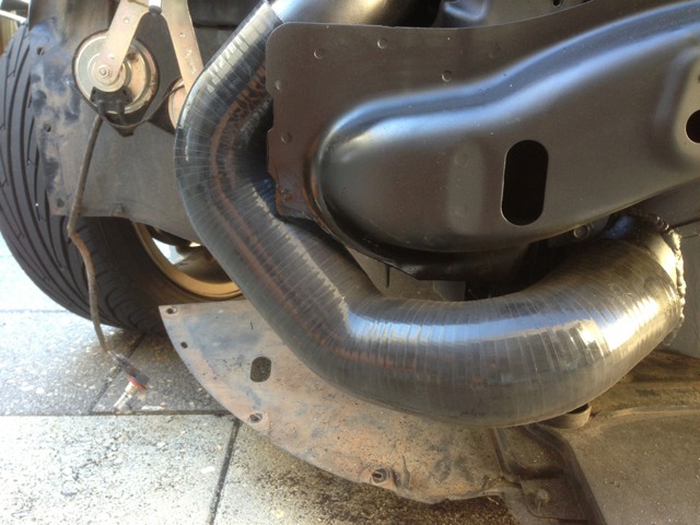

Previous owner said he trimmed it so the hose doesn't contact the front bumper :( F*ck I hate being ripped off! -
Nizpro Offset Intercooler Install Pics.
AdamIan69 replied to AdamIan69's topic in Intercooler Workshop

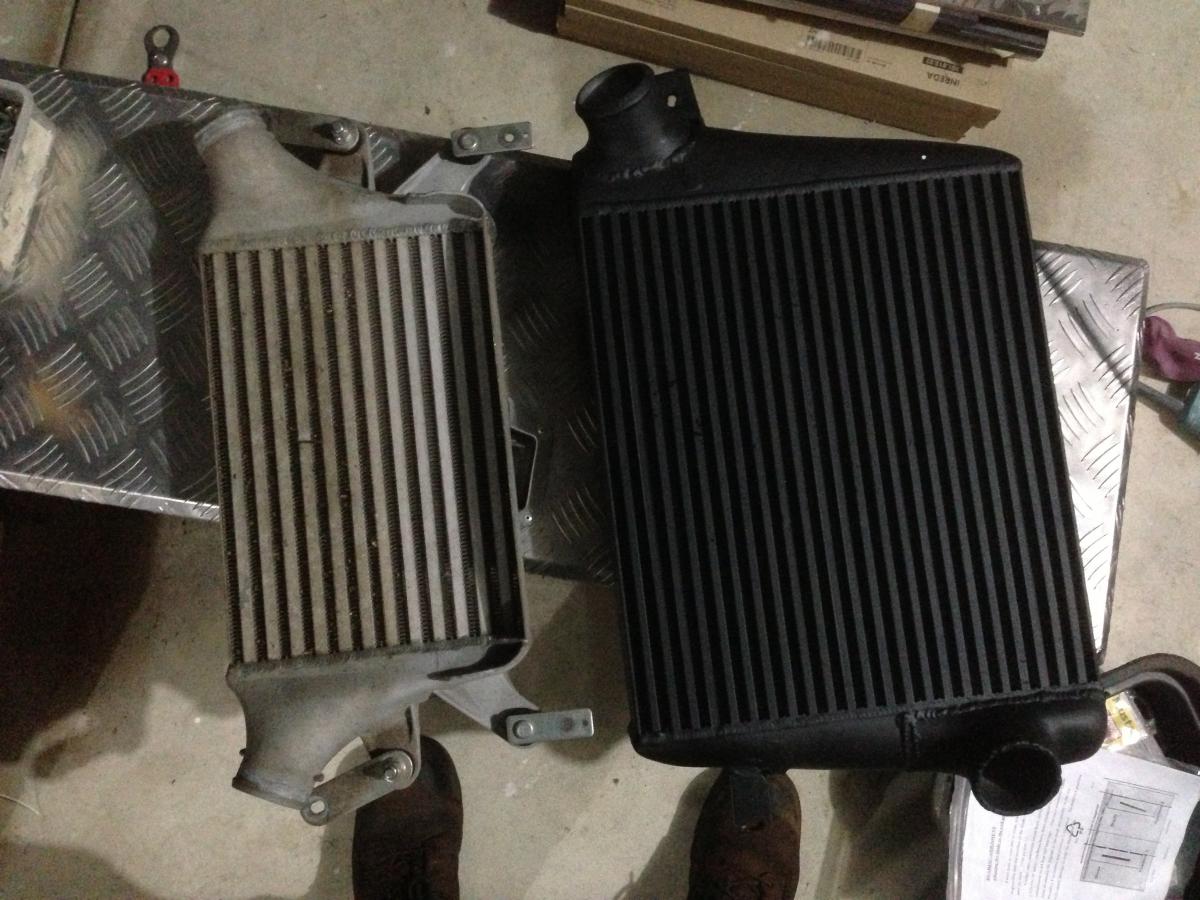

Oh really! The bottom mounts were already welded in place and the piping seemed to fit a treat, with some massaging ofcourse. Also if it were mounted higher it would mean I would have to take more steel out of the crash bar on the driver side for the hot pipe and I was already getting close to the horizontal section that the crash bar welds onto and a spot weld that I wanted to leave in place. I don't think you "really" need to take any steel off crash bar on the passenger side, but if I didn't the hose would have touched it (just). I admit I got over zealous on the LHS. I didn't follow the 5 "P" rule. I did buy my cooler second hand ($700) (cooler piping kit new was $600) the previous installer may have moved the mounts. For what reason I am not sure. Do you think the cooler looks small? Compared to the ones you have seen? -

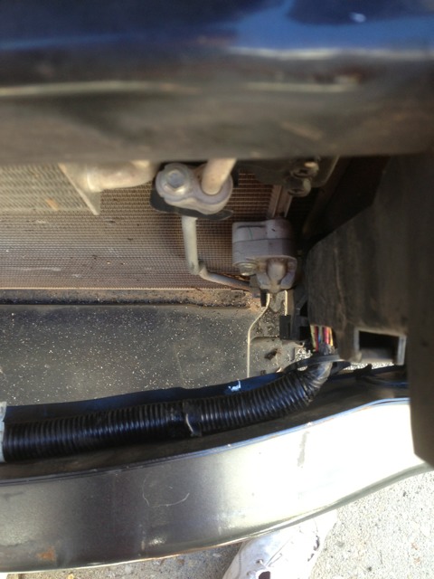

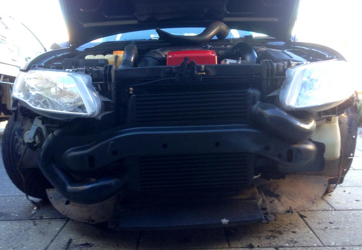

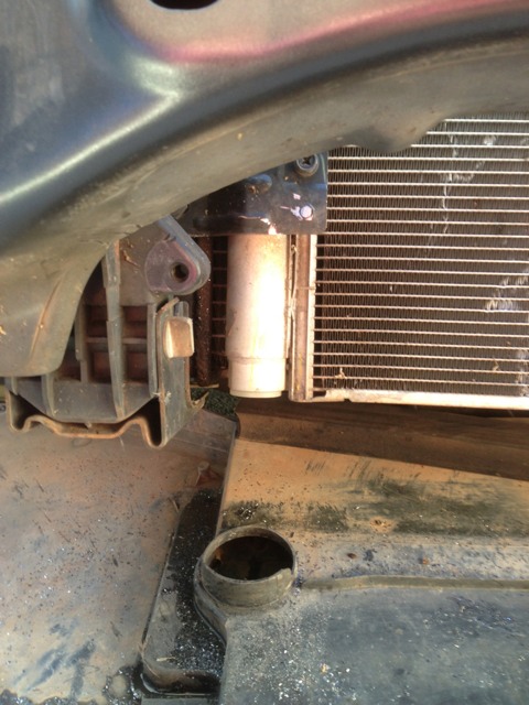

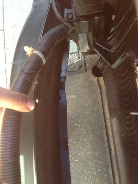

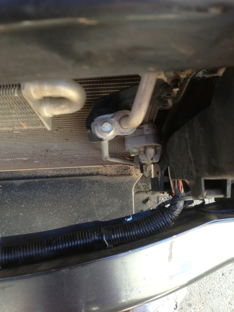

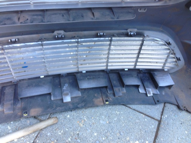

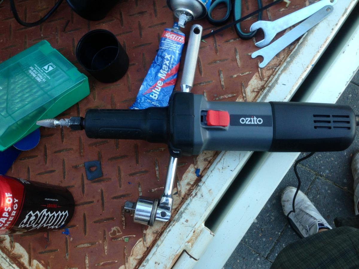

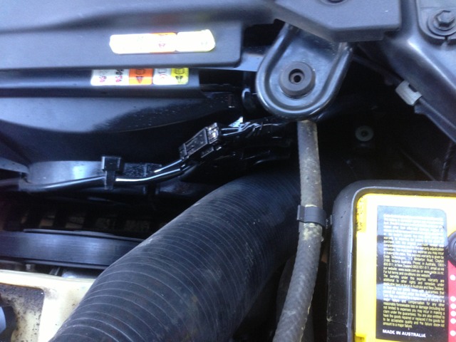

When opening these holes up, ensure you caress them gently with the die grinder. If you don't the plastic will chip (big chips) and your hole will look like you opened it up with a hammer. I have had hoses blow off while driving to very important lunch breaks, so I glued all my joins that sit inside the bumper. You dont need a hose blowing off while being charged premium rates for being on the dyno. This is a personal thing, but it works! This is how I worked the air box around the cooler pipe. I left the snorkel in there but trimmed it as you can see. I cant see any hot air being drawn into the air box while sitting at 100km/hr 1000hp cooler? I couldn't see it if I tried This electric die grinder worked a treat and as I see it, it is a must for this install. I hope this helps some one. Just had an enquiry for more info. So here are some more pics. Before After Before After Before After After After- removed to clear the hot side pipe. Before After- for some reason the hole was to small. Hint hint nizpro. 10mm drill bit and sensor safe silicon does the trick. After- I removed the steel to clear the cooler end tank. After- same on the passenger side. After I cut the bolt on the condenser bracket. (6mm bolt of no use) After- you can see on the passenger side I removed steel out of the crash bar to clear the cold side cooler hose. Before After After- I put an extra bit of silicon hose there to protect it from a rub through. After I moved the fan plugs out of there socket. After- you can see in this pic that there is no centre support. I cut it out, and you can see the burr marks on the uprights if you zoom in. Also buy a can of no primer required kill rust mat black in a spray can. Spray all the mods you make, to seal the steel, to prevent rust and make it look like a professionals job. All the best.
