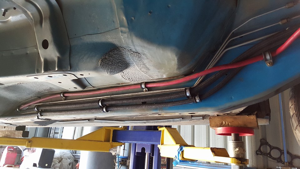

  3. Bit of an update.. New engine mounts. Allen key sump bolts. TH400 cable fitted up. Speedflow braided fuel lines throughout. Socket head bolts for the bellhousing. Ecliptechs V2 version of their shift light, tidy little unit! Motor is now in..

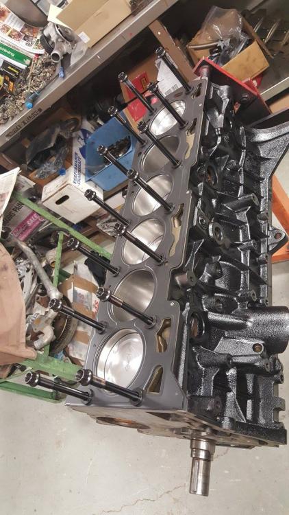

  8. The other parts of the build that I missed. We recently finished the head for the motor and consists of.. - Faced/glass beaded. - Race ported head specs and port matched to the inlet manifold. - Standard valve seats removed and larger aftermarket ones inserted to suit the oversize Supertech titanium valves inlet/exhaust with single groove collets. - Supertech valve springs with titanium retainers. - New lifters. - Stock cams. Also finished of the surgetank set-up aswell... - 3litre surgetank with x2 Walbro 460s inside, all factory lines removed and replaced with braided.

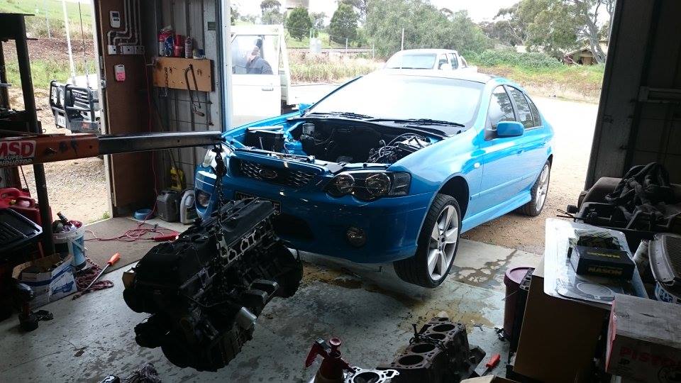

  15. Hey guys, thought id share some progress shots of my build so far that me and my old boy are doing at the moment! everything is done in house by us!! Soon to be tearing up the streets of Adelaide!
