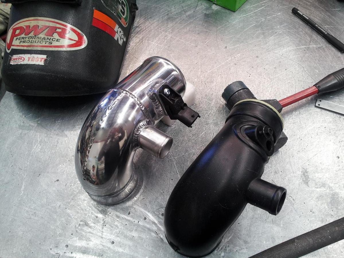

  21. Hi all Just a quick update on the G6ET. After work on saturday I made a new intake elbow as the OEM plastic unit looks like a dog turd. I have also heard stories of them blowing of and putting nice dents in bonnets? I noticed when I removed it that the raised bead isnt very large, not nice above 1 bar. I made a new unit from a 3" alloy donut with a 10mm piece of flat for the map sensor. Didnt take long at all. I will have to upgrade my cold side piping to 3" now!!haha I have attached some pics Got my ID1000 injectors on Thursday and will begin the battery relocation and drivers side air box this weekend coming. The 3.5" exhaust the weekend after that along with a 12psi W/G can. Its then back of to the dyno to see what I can squeeze out of the stock 35/76. Im not expecting much more but would think it should manage 330rwkw with better mid range due to the exhaust, shorter inatke and 12psi can. Hopefully it will hold 17psi rather than dropping off to 14. Take care all Kind regards Jon
