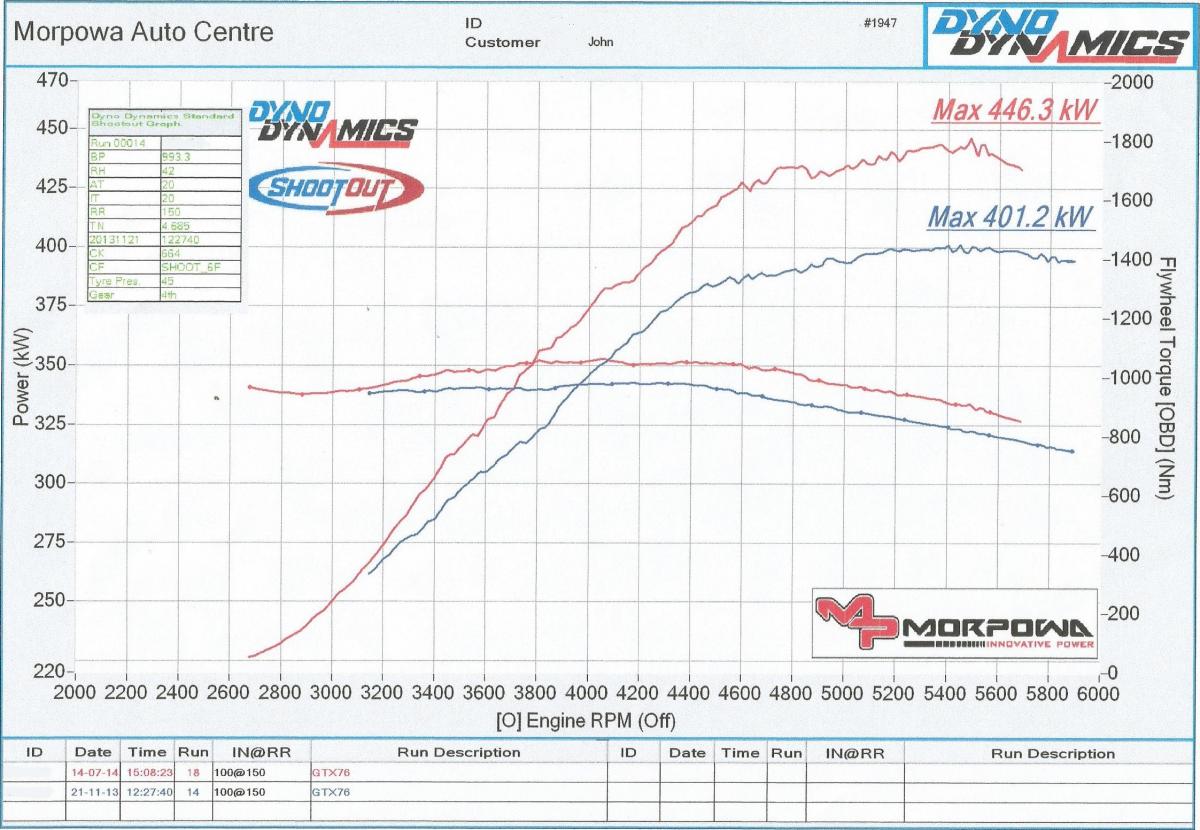

  2. Yep really happy with the little 76. It just needed a bit of a hand to free up intake and cooler charge air. I will ask Simon if he can send me a copy of the boost map. We were looking at it yesterday. Like I was saying we had to bring it on softly as its a bit nasty hitting 22psi fast lol. Yep still on E85. Just had new diff bushes fitted today...........again! Good street combo, just need to find some decent 20" tyres You coming to the street meet Jet? Be good to put some faces to all the names! Kind regards Jon

  4. We had to dough down the boost delivery early on as it hits so hard with the little snail. We hit 100% duty on WG solenoid at just before 4000rpm. Again cant see much more than 21-22psi with it tapering off as the little snail is out of its sweet spot. If we hit the boost harder down low she would definitely make some more up top but its just turning the tyres on rollers no matter how hard we strap it down and how many people sit in boot. I think that's when the engine gets a bit dicey with boost hitting so hard too. Still I will crank it up that bit more when its time for the built engine and bigger snail just to see where it could have gone. Spewing I didn't data log intake temps but the throttle body pipe was stone cold while the hot side was burny hand hot. Will do some data logging soon and post results. Highly recommend Simon as my tuner, very talented with a fine attention to detail I have yet to see from any other tuner I have ever used in SA. As for getting power down, it doesn't. Anyone running 20" Nittos, thoughts? Kind regards Jon
  5. Hey Guys Well the G6 finally hit the rollers today, OMG did that new cooler make a big difference. I also fitted a 12psi wastegate can but the little 76 still has some probs keeping boost up there still. Well it made nearly another 100nm of torque and power rose to 446rwkw while still being quite conservative. Will bag that 10sec ET easy as now. I feel we could have pushed it a bit more with a leaner afr and bit more boost in early and easily got over 450, but hey Im very happy with the result from the little snail! Here's the dyno sheet, cant wait for street meet in couple weeks Kind regards Jon

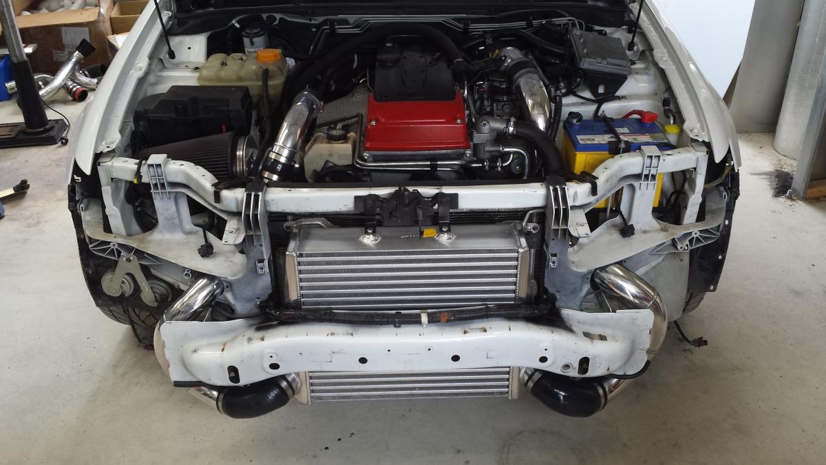

  9. Hey everyone. Ok so coolers all done, really happy with overall fit-up. Looks good behind grill without being in your face. So now its changing to a 12psi WG can, and the cat then its off to have afrs tweaked. Here's a few more pics. The cooler is soooooooo light which is an awesome thing. Its sooo much lighter than the PWR stepped tube n fin its replacing. Should be a very very efficient unit. I think the street meet has been cancelled this weekend so all good. Will try for that 10 next time. Will keep you guys posted on what we can get out of the lil 76 on the rollers next week Kind regards Jon

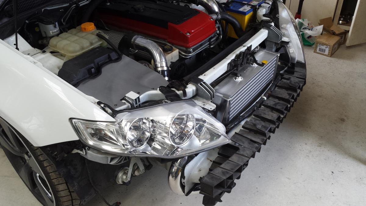

  11. Hey Guys The cooler is finished and bolted in. Wow what a tight fit!!! Bit harder with tube n fin as the header plate/ tanks are1 1 inch wider than the 4 inch core. This makes it rather hard as the front intrusion bar tapers back in on edges making it even tighter. The radiator had to be spaced back 35mm with some customizing of lower supports. Overall I'm pretty happy with the fit-up. I finished new hot side piping today in 2.5" and will fab the 3" cold side tomorrow. It was shocking weather to push car outside n take some pics but here's a couple showing the new setup. Will post more in next few days. Speak soon kindest regards Jon

  14. Hey Guys I hope everyone has been well. Sorry for the delay in getting the rest of the G6 done. Ok so I finally got a chance to get her into the workshop and start on the new cooler. The core is a lightweight Euro tube n fin, its massive!! The core is has 490 tube length and will end up being 5" or 125mm thick with tanks. It has been a very tight squeeze to get it in to where it sits at moment. I will start folding the sheet tanks tomorrow, I did stay back for a bit tonight and tried a few temps out made from card. Anyway here's a few pics of where it sits at present. I will post more as the build goes along, then its of to the dyno again next week Kindest regards Jon
