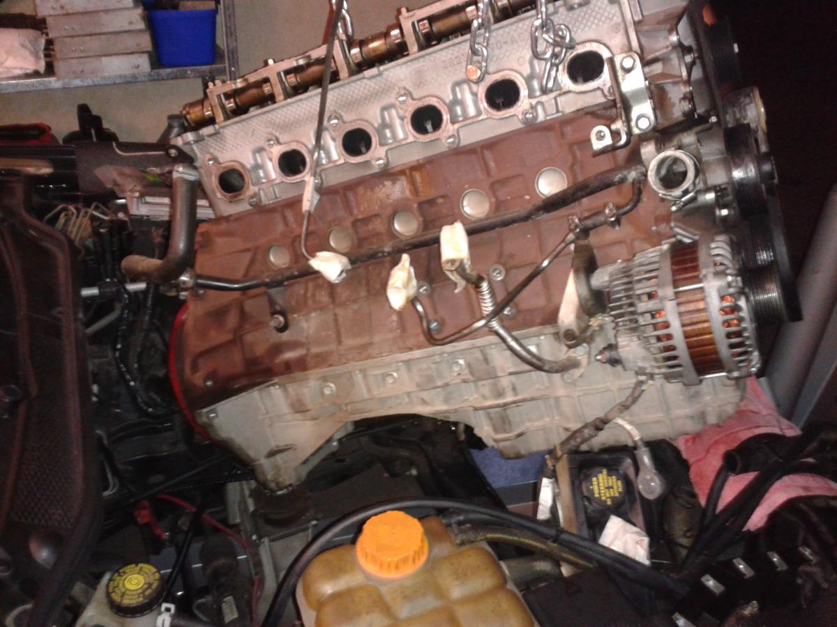

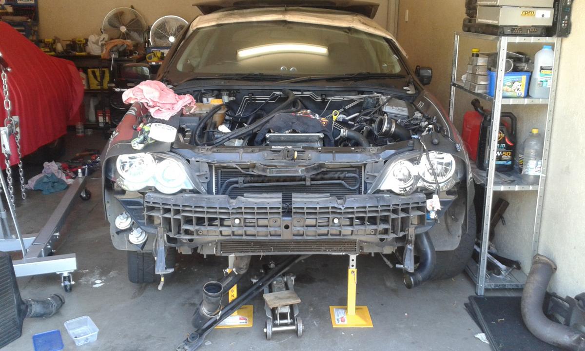

  20. Hey guys my Typhoon has had something metal bounce around in cylinder 6 which closed the gap of my spark plug and looking with a borescope has done a nice number on the piston, we suspect the possibility of part of the cylinder cracking off, engine is only lightly worked with the usual assortment of stage 3 process west intercooler, throttle body relocation, bigger injectors and exhaust, 16lb actuator and tuned to run 16psi on 95 in darwins wet season with 482rwhp. I will be removing the engine and sending it down to Jack Brothers in Brisbane for a set of forged internals, machine work and possibly some aftermarket cams. I am currently part way through the engine removal, just about ready to bolt the engine up to an engine crane and pull it out, since this is my first engine removal I have several questions that I cant find much info on from the Gregory's manual and from forums, so it looks like somewhat of a tight fit to get this donk out, will I be looking at running into dramas with room, I have removed the thermo fans but not the radiator. Any info would be awesome as I don't want to be screwing around with stuff while the engine is suspended. Cheers, Newy
