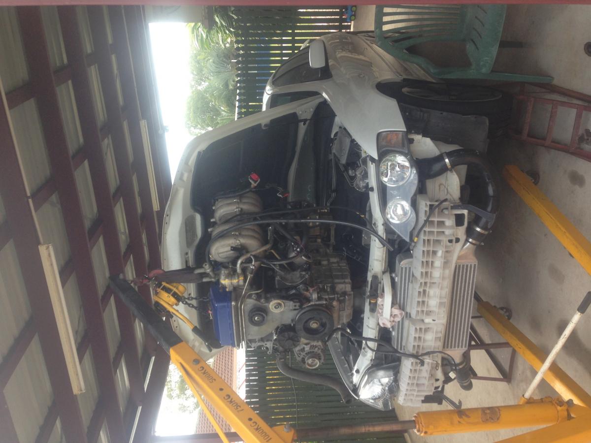

  1. Finally going in... Now to run it in them injector change and e85 tune!!

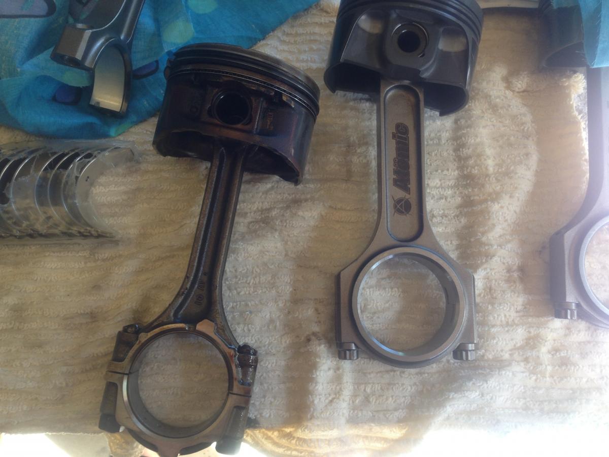

  3. Just though I'd post a few pics of my bf f6 engine build. Was making 550rwhp with the stock engine put I had a fuel pump issue and ended in a melted piston. This is the rebuild so far.. I'm running 20thou over marhle pistons, atomic I beam rods, spool stud girdle, arp head and main studs, spool oil pump gears and a MLS head gasket

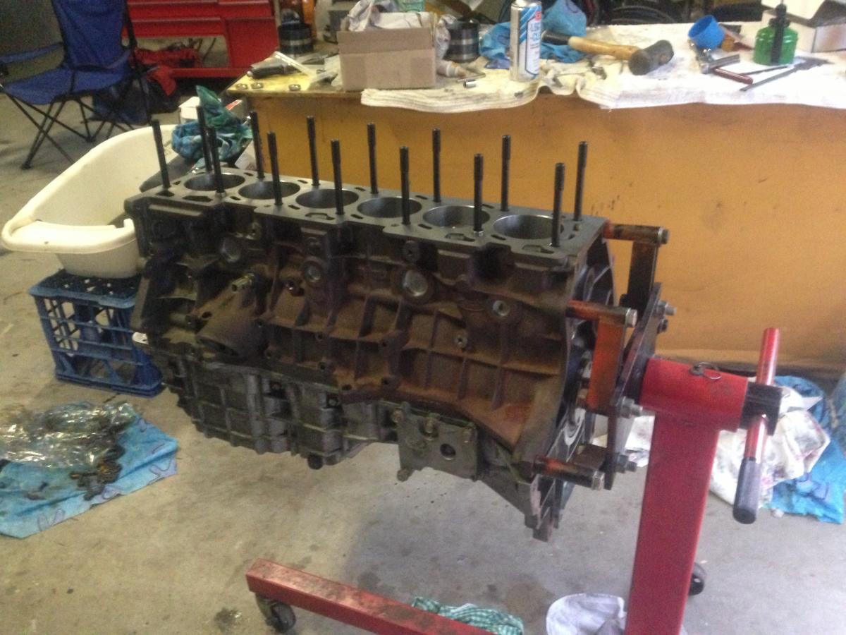

  4. Can anyone tell me- when running a spool main girdle do I need different arp main studs because I'm assembling my bottom end and my studs seem too short? Also then didn't come with a tightening torque!
