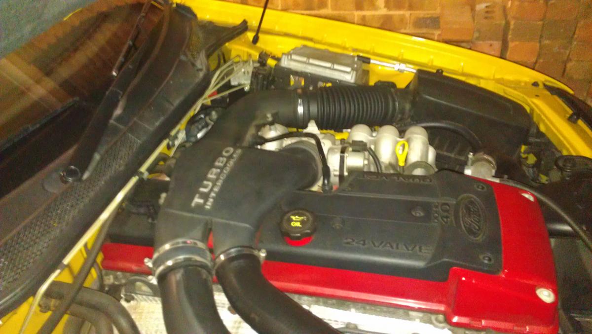

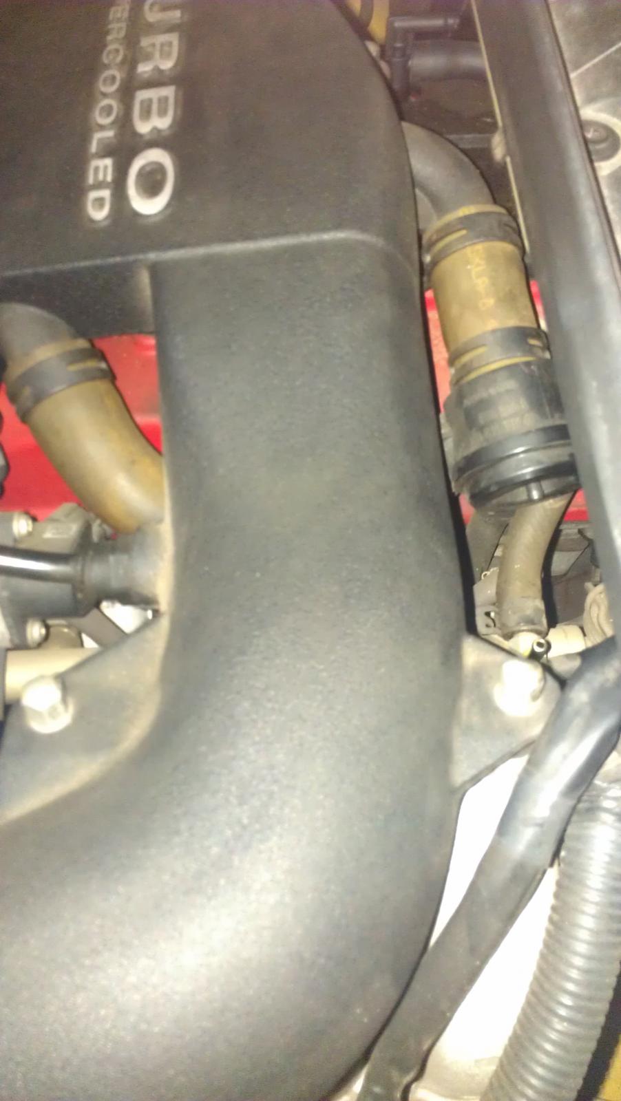

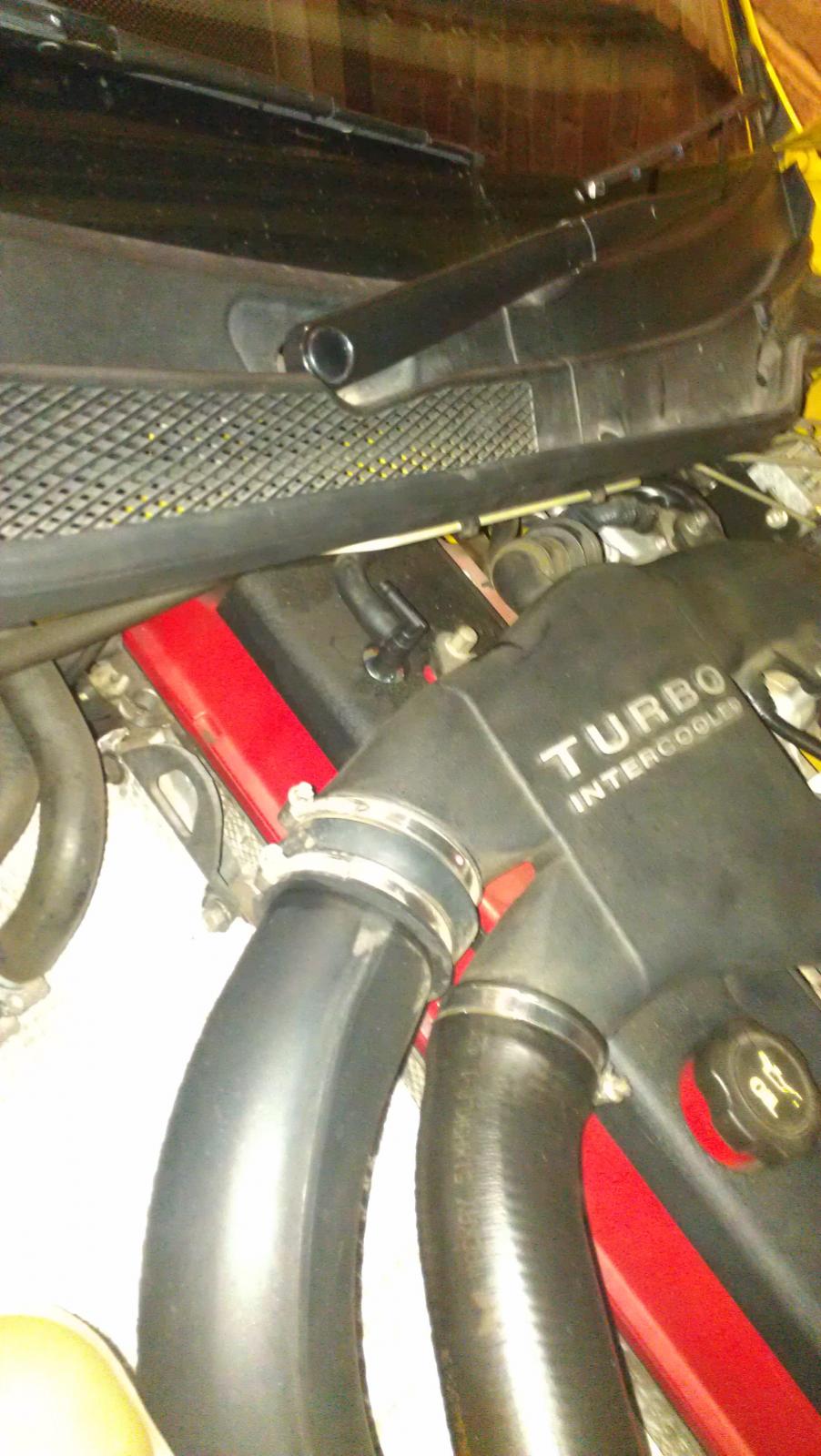

  14. if you have a look at my first pic, that was all the vac line I had :( so I'm assuming no bov
  15. do these help??
