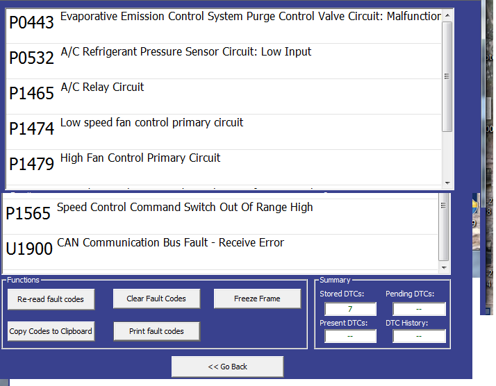

I'm looking at buying one of the Chinese clones of the VCM with the IDS software. Has anyone had any good/ bad experiences using them on the Falcon/ Territory? I want one for configuring the PCM settings. Is there any alternatives? I have Torque on Android, and Focom on Windows7, but they are really just for scanning codes and reading data. Where is the best place to buy a VCM clone at a good price?
I've put a BA turbo engine into a Nissan Patrol and it seems somewhat sluggish (struggles to get to 3000rpm). When I take off it feels ok, but when I go to 2nd/ 3rd gear etc the boost struggles to go past 3psi. When the engine was still in a Falcon it drove fine. Also the thermo fans dont work with the PCM. If I ground the relays manually they work fine, and they don't log codes during the KOEO self test (unless I have the relay disconnected) so it appears to be wired fine. Would any of the following codes bare any effect on my situation: P0443 Purge valve P0532 A/C pressure sensor P1465 A/C relay P1565 Speed control command switch (Cruise control??) P1900 CAN With the fan relays disconnected I get P1474/ P1479 codes. Would this affect drivability? Do I need to connect any of these in order for the PCM to work correctly: -Brake switch -Clutch switch -Cruise switches -A/C relay/ pressure switch -Vehicle speed input I've also fitted a bigger intercooler, a 3 inch exhaust with no cat, and FG exhaust manifold/ dump pipe.
