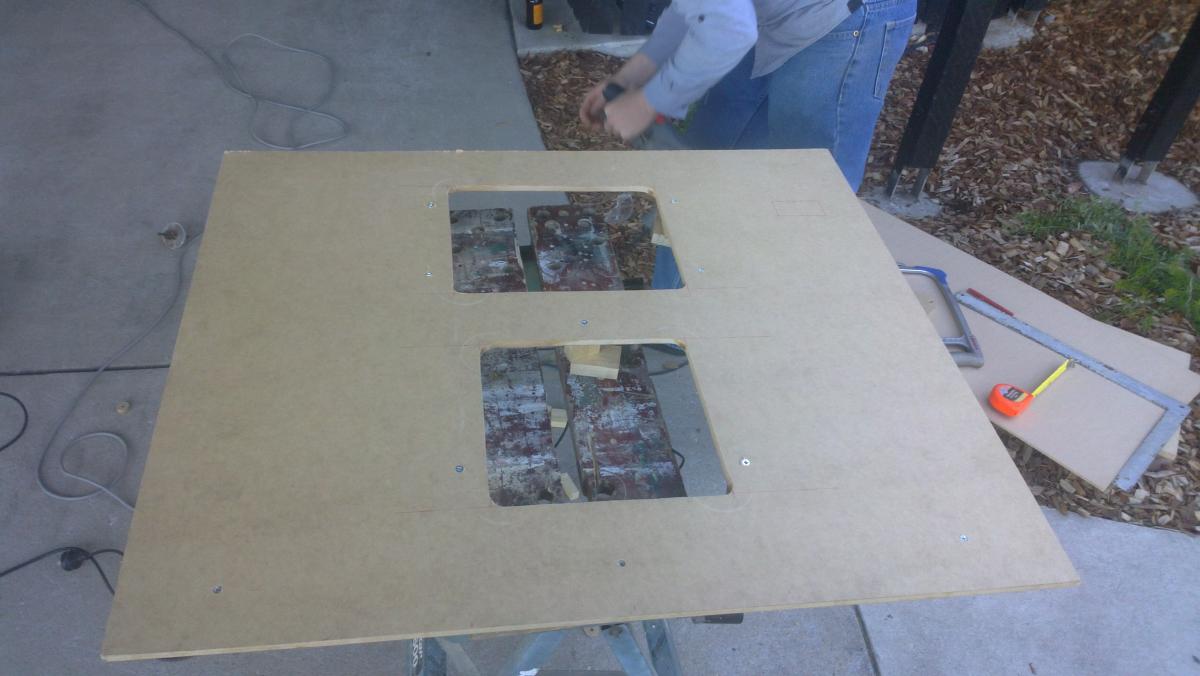

So I managed to pick up a cheap option audio 12" sub and 2 amps from a mate. I have gone with a dual slot ported box, running up the front of the boot near the seat. There is a perspex window in the back of the box so that the back of the sexy looking sub can be seen when the seats are down. I chose to mount the amps flush with a false floor, but will end up changing so the floor has a hinge so I can get the spare tyre out semi easily haha. Have gone with a purple lighting scheme too...photos dont do the colour justice, it looks pink. But trust me, its definitly purple Thoughts? Suggestions? Its still a work in progress, will keep posting photos. Has taken me 3 weeks to get to this stage, as I can only really work on in on weekends. Amps + colour False floor: Carpetted floor: Box progress: In car:
