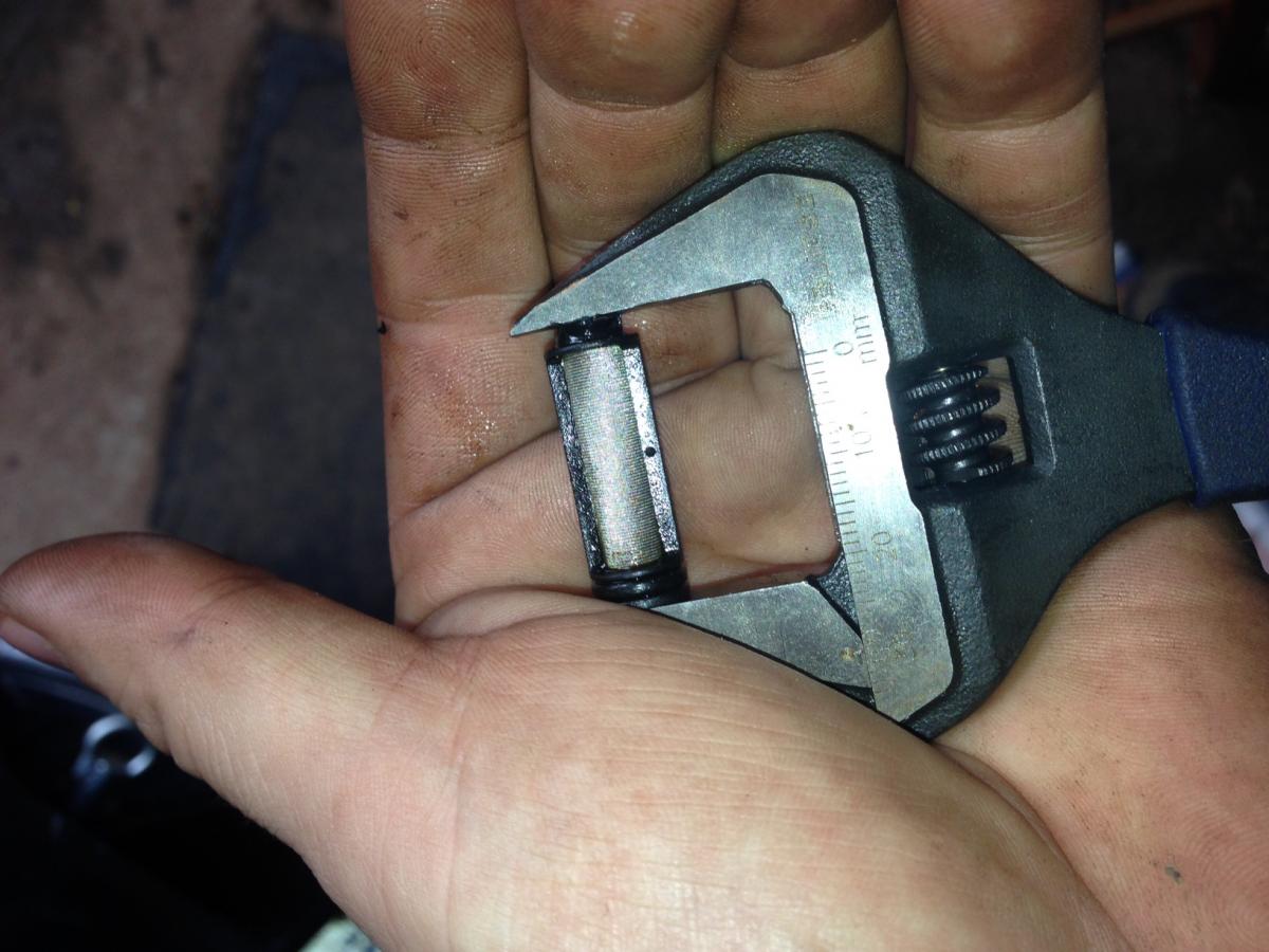

Here is what stuffed my turbo, I blocked off both ends and couldn't blow through it. Some oil must have still gone through as the ute smoked a lot!!! I burred off one of the nuts on the bottom side of the turbo (they are tapered) so ended up having to take the manifold out. Real bastard of a job as all the bolts pulled out their fair share of alloy, took huge amounts of force and I thought I was going to break them. When I reinstalled I cleaned the threads and used loctite blue. Went in OK. The aftermarket 4 inch dump pipe has no room for a ring spanner or a conventional open spanner, real bastard as well and awkward to reach Another one that I don't have a photo of was the turbo to sump feed. I was stupid and didn't bolt up the turbo side before I put it back in. Absolute nightmare to bolt up when turbo installed. Here is the old intercooler versus the new intercooler. Biiiiiiig difference. The new Process West Stage 1 was a tight fit, it also removes any rubber mounts. Bloody works though! Final Result!!!!
