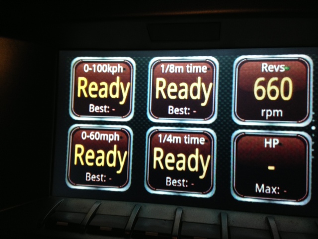

  1. Hi, Bluetooth OBD2 diagnostics reader, plugs into OBD port and stays there, I've also fitted an OBD extension lead and cable tied the reader to the side to take the weight of the OBD port (reader is bulky) and was also able to place the fusebox cover back on. Cheers.

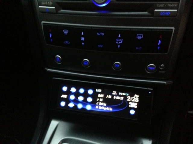

  5. Premium/colour ICC's have a video input for dealer optioned sat nav/DVD. Yes, Galaxy S RCA TV out cable plugs into converter, which converts the signal to NTSC (only format ICC supports.) Here's a Fordmods link which goes into depth, which should clear any confusion. http://www.fordmods.com/documents.php?d=38 Cheers.
  6. that's correct, JVC h/u outputs to a carconverters PAL/NTSC to NTSC converter, which outputs its converted signal to the ICC. Converter accepts 2 video inputs, which are switch controlled: switch on left flicks between H/U and phone AV inputs, switch on right turns converter on/off, which returns ICC back to factory dual zone climate views. This isn't necessary though as the climate control pops up whenever a button on dash is pressed, just like factory optioned satnav/dvd does. Steering wheel controls were retained via a SWI-JACK. Samsung Galaxy S's TV out function, which outputs into converter -> ICC. Phone is mounted in glovebox and is always charging. Thanks guys.

  10. a video converter with 2 inputs purchased from carconverters.com.au, phone pairs with a Bluetooth OBD2 diagnostics reader when key is turned.
