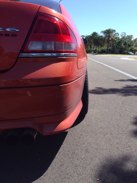

Hey guys, Trying hard to sift through all the threads to find an answer, so I'm hoping someone will be able to help me quicker. Basically I'm after a wide as possible rim as I can get. Plans are to to have the rim flush with the rear guard and 265 tyres (tiny bit of stretch). I currently have 17x9 +15 on the rear. I've been using the 1010tyres offset calculated and pretty much got most of it figured out, but what I'm worried about is one of the bolts on the lower control arm. Not sure if I'll get an 18x10 in. If anyone has done this, can they please let me know what offsets work and pics if possible !!! Promise to post pics when I get it figured out and the new rims !!!
