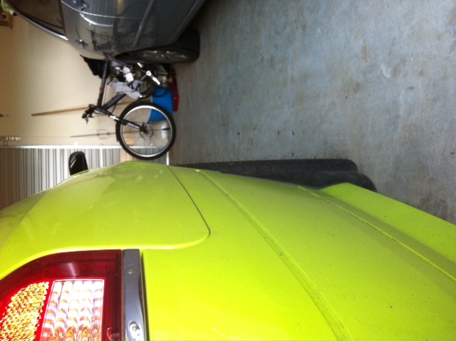

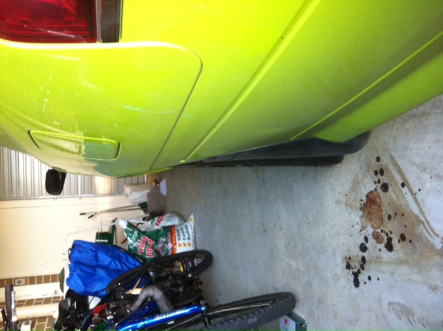

  1. Hey fellas I noticed today while standing at the back of my car that the RHS wheel sticks out further than the left.. I was paying more attention to the wheels sticking out today as I fitted some spacers and wanted to see how it looked from the tail end. Kinda makes me wonder if its always been that way as its something that could have been overlooked in the past.. I not long ago changed my diff and blade bushes. I did make plenty of witness marks though and I'm fairly certain I didnt put it like 10mm to far to the RHS. Also measured from a consistent reference point on both sides of the car to get the cradle 100% square aswell, kinda got me stuffed.. Has anyone encountered this before?
