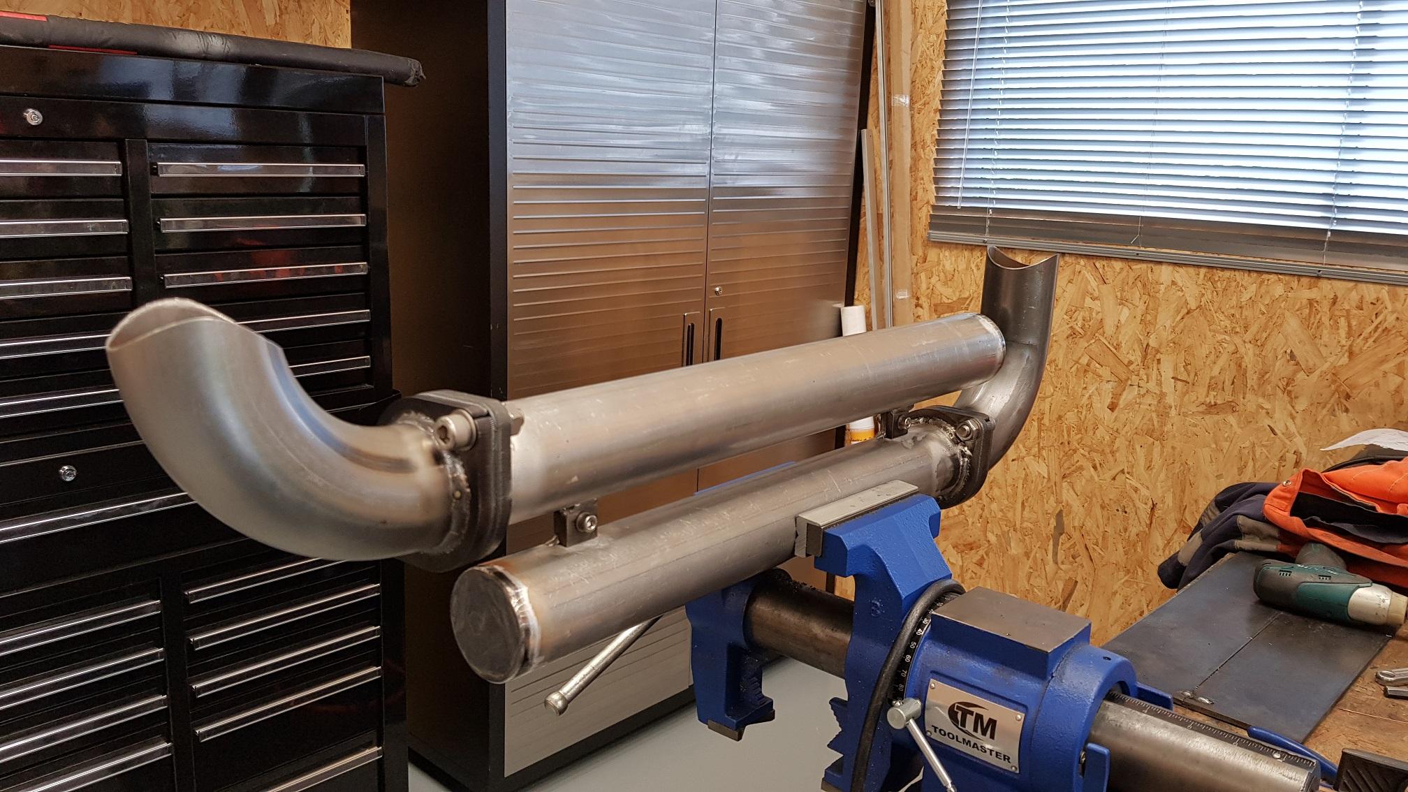

  9. I'm familiar with drone and j-pipes. I made these and put them on my VF. Made a world of difference. What I'm experiencing now feels like a much different phenomenon. I wish I could put into words what it's like. I
  10. Its not drone so dont think j pipes will work in this case???
  11. @Captain Yeah Nah thanks mate, I have a 14" long hot dog laying around from a previous build that I'll shove up there and see how it goes. Out of desperation hence my reason for reaching out is I was considering changing out the rear muffler and adapting 2 x Lukey 2.5" turbo flow singles in there. Have to check clearance etc. But seems a bit drastic and another $500 down the drain. Was also thinking maybe I could put some small 6" hotdogs between the rear muffler and tips on the back, kind of like a silenced tip if that makes sense. Not fussed about volume, the quieter the better to be honest.

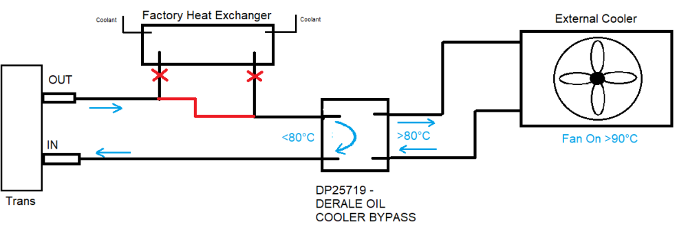

  17. Hey @JETURBO what I was finding in winter the trans wouldn't adapt when I made changes to shift pressures unless I cained the f@ck out of it and got it hot. The purpose of this mod is to keep it in what I think is an 'adapt temp enable zone'. Cheers.
  18. Yeah its a ZF. Just looking at some data logs going back to winter. I currently have the HX bypassed and am running straight to the external cooler which is mounted down the back (ute). In winter trans temp never exceeds 65°C. Summer temps are good at around 70-95°C. So what I'm looking to achieve is a narrower range of temperature all year round. Ideally 82 to 92°C based on the switch points of the cooler bypass valve and fan thermostat plus some hysteresis and dead time. How about this...
  19. Hey, anyone see any issues with this set up? Thinking it will keep a stable 80 to 95degC no matter what the weather and have quick warm up time...
