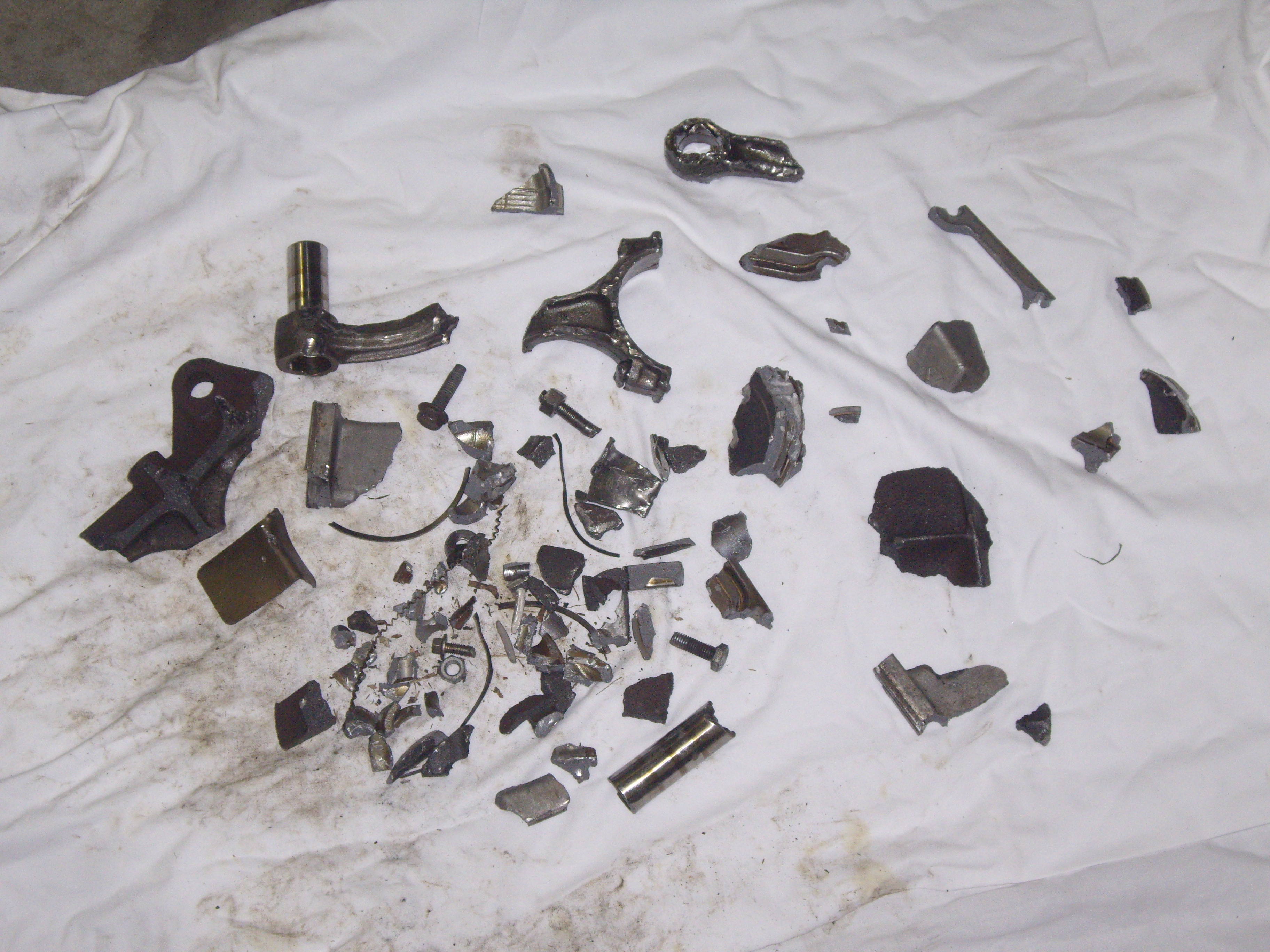

she looked like I hit the transbrake off the mark, but that was just the hand and foot brake. I was just thinking, if anyone doubted it was a stock motor, those bits should prove to all it was just our humble little BA clunker. David -

[attac hment=46949:IMGP7043.JPG]Some are hard to see, and one is looking from one side of the motor through to the other side. -

Just had a look at my motor, seven different holes in it. David -

Yes, I think I found and exceeded the limit of a BA motor, the car had 2 more psi, and about 50hp extra, (I would expect 800 engine hp) she left a bit untidy but still with a 1.4 60ft, she was quicker at the 660ft mark, and up by 2mph, felt like it was still loving it. then all went pear shaped, clunks and bangs were coming out of it everywhere, looks like 2 and 3 came out each side. she still idles but sounds a bit tougher without the other 2 cylinders. good info for my new engine though, because it feel real good for the first part of the track, nearly 112mph in 200 meters is sets up a good finish. I was thinking of putting a BF motor in and see what it can do, but the way she blew, I think it might have been the pistons that let go, before the rods, I feel I would have got a drop in power for a bit as they bent if it was a few rods bending. imo. time to get some grunt out of this car. there was also a lot of PBs for other cars to Nathens BF F6 (stock auto) (stock motor)ran 10.95, @127.7, 10.98 @127.3, 10.95 @ 127.4. M selby BA xr6 (stock auto) stock motor with valve springs, ran 11.3 @126mph BClarke BF GT Ken Bell supercharged (stock auto stock motor) ran 10.94 @127mph D Anderson BA xr8 Ken Bell supercharged (stock auto, stock motor) ran 11.2 @122mph Joal xr6 t BA (stock motor and auto) 12.0 122mph John BA xt with stock NA auto but with a stock BA xr6turbo motor ran 11.95 at 121mph on old nangkangs. shane first time with his car, ran 12.5 at 118mph on street tyres Tony from PRE, ran a pb xr6tstock motor and auto, not sure of his best but I saw a 11.6. David -
