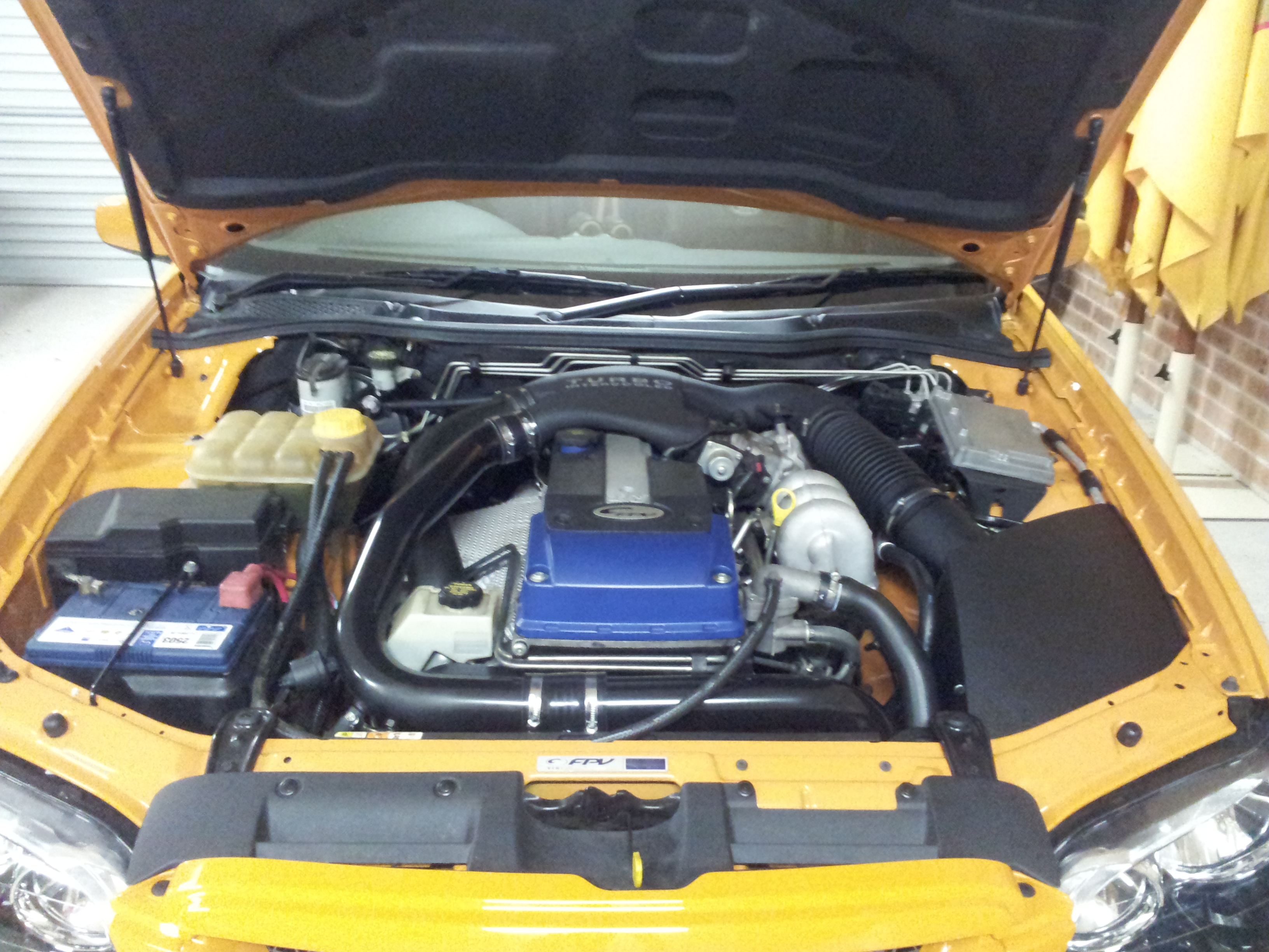

  3. The tuner says it should be making 340+kw Before I did turbo upgrades, valve springs and injectors I was making 325rwk on 12psi boost so dosent make sense. This is the set up im running.
  4. Hi guys im in need of some help with an issue I have with my BF F6. I have taken my car to my tunner to see if I can get some more power with the latest improvements I have do and the issue I am having is the more boost I put through the less or little gain im getting. I have been told that there must be something blocking or restricting my boost or flow as we ran up to 19psi and only made 320kw. These are the mods I have done to the car: 1000cc injectors. Atomic valve springs. Custom air box. Process west stage 2 cooler with standard crossover piping. Hot side piping. Modified factory turbo to a GTX3582R Gen 1 chra (62.5mm compressor) with a 12psi actuator and ported. 4inch dump 5inch 100cell cat 3.5 inch system. I have checked cat and it is clear. The only thing I have found is the hot side silicon joiner is slightly squashed between the fans and radiator support could this be the cause? Any help would be great. Thanks
