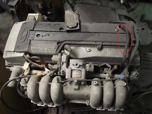

so refering to the picture I posted there is another breather on the back of the rocket cover?????? would you by chance have any pictures of the setup of what you've done it'd be great to get a better understanding of it as it could solve the problem. so should I do the compression test and post the results? or look into how to do a leak test which I have no clue what it is without further investigating it pictures of your setup would be great! -

hi Ian thankyou for the reply. I will be doing a compression test on saturday, do you have an idea what the original specs or what the compression of the cylinders should be so I can compare when I get the readings?. I've attached a pic of the xt engine of what ive done its not my engine but similiar. I havent done anything with the pvc yet. its not the exact pic.. but the front breather is the one I vented to atmosphere through a catchcan. I havent touched the pvc valve at the back yet, I thought id replace it just incase that's the problem and do a compression test and see what I come up with. -
