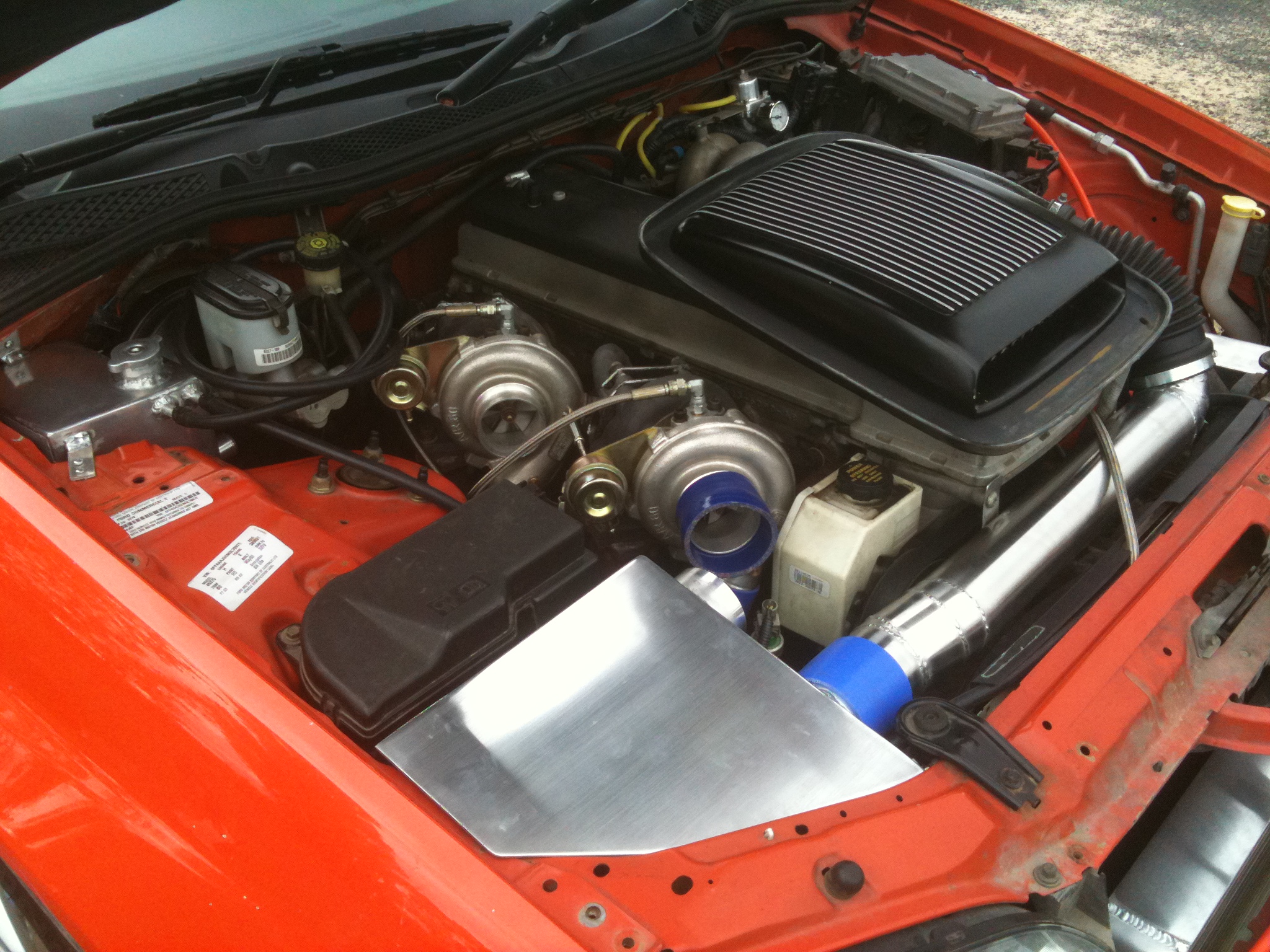

  1. Hey Guys, Its finally finished! All the pipe work has been completed and now its soon to be heading to the tuning shop to see what numbers we can get out of her! Iv been for a small drive with it running low boost and adjusting the air fuel ratio wit an air fuel meter and it seems to crack like a whip!! Cant Wait to see what it does with some computer adjustments and 10psi up its arse!! Ill post up the dyno sheet as soon as the tune has been done!

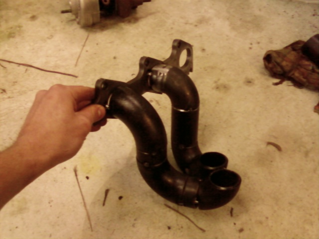

  2. There is a curved plate in the center of the smaller pipe that will direct both flow paths into the larger outlet pipe, that is the only way I could direct the pipe work in the direction I wanted it.
  3. Hey Guys, Here are some pics of my ba xr6 twin turbo set up, I really like the look of revenge's header pipes, (I 110% respect how hard they are to make, and you've done an awsome job on em they look sick!) but a high mount twin turbo setup looks awsome! this is the only way I could think of getting the pipework to fit under my bonnet. and this car is street legal!

  9. Hey guys, Here are some more pics of the build to keep you all interested!!!! From some of the pictures you can see the new alloy radiator overflow tank iv made to sit in next to the brake booster, this gives a lot more room to run the 3" intake pipe to the second turbo. Iv also relocated the battery to the passenger side of the engine bay where the old air box sat, and piped the shaker back into the new air box to give some of that cool air we all love!! Any one with questions, please ask, I love tellin people about my project. Enjoy.

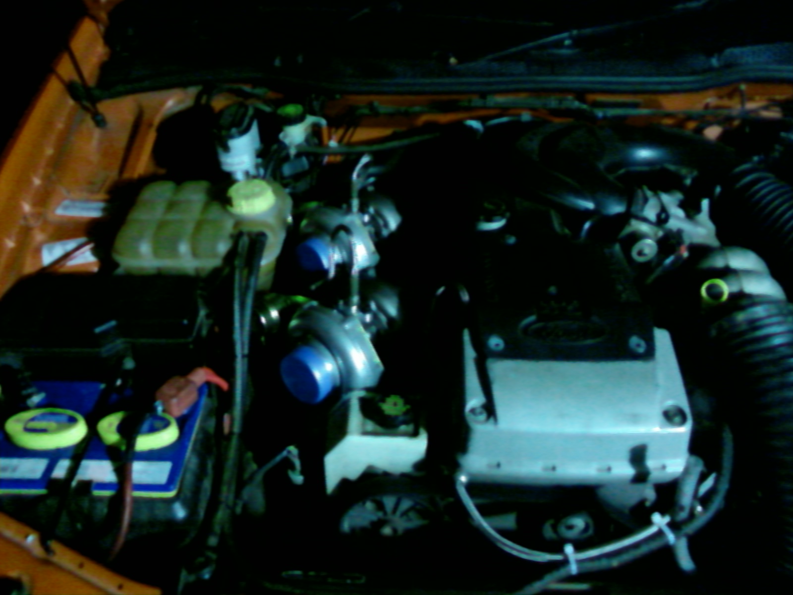

  13. currently in the process of relocating the battery and making a new alloy radiator overflow bottle and relocating it closer to the firewall

  18. Cheers for the support. Yes t04e turbos Yeh turbo's do sit pretty close to the overflow bottle, but im gunna put a catch can instead, and run the hoses into a different spot so they dont interfere with the waste gate actuators. Got a heap of fibreglass wrap to go round the manifold and dump pipes try and keep the heat down a bit, thinking about putting aluminium barriers up to protect the heater hoses and hydraulic clutch line. Gunna control boost with a dual stage electronic boost controller. Waste gate springs are both set to 8psi but with lowereded compression and possibly forged pistons and rods will hope to run upward of 14psi. My understanding of the boost controlling is once manifold pressure reaches the boost I want both gates should waste equally to regulate to desired boost, even if one turbo is making 8psi and the other is making 6psi, once maifold pressure reaches 14psi they should both regulate equally. Currently got an old sigma on lpg as my daily driver while im working on the ute, hoping to get a good bit of work done in the next few weeks, ill update progress as it comes. Any info people want to know just ask, im more than happy to share my success and failures. (more failure than success so far)

  21. The reason why you cant use your pacemakers is because they are mild steel. the heat and pressure generated beteen the engine and the turbo would melt the headers faster than you can say holy sh*t. Iv just finished makin up a set of header pipes for a twin turbo conversion on my xr6 and its all been made out of 5mm thick steam pipe. The reason they say your stock headers will work better is because they are cast iron, and can handle the heat and pressure. The only other way to go is to get a set of headers made out of stainless and are ceramic coated. But if your making a kit that will last the best option is the steam pipe.
