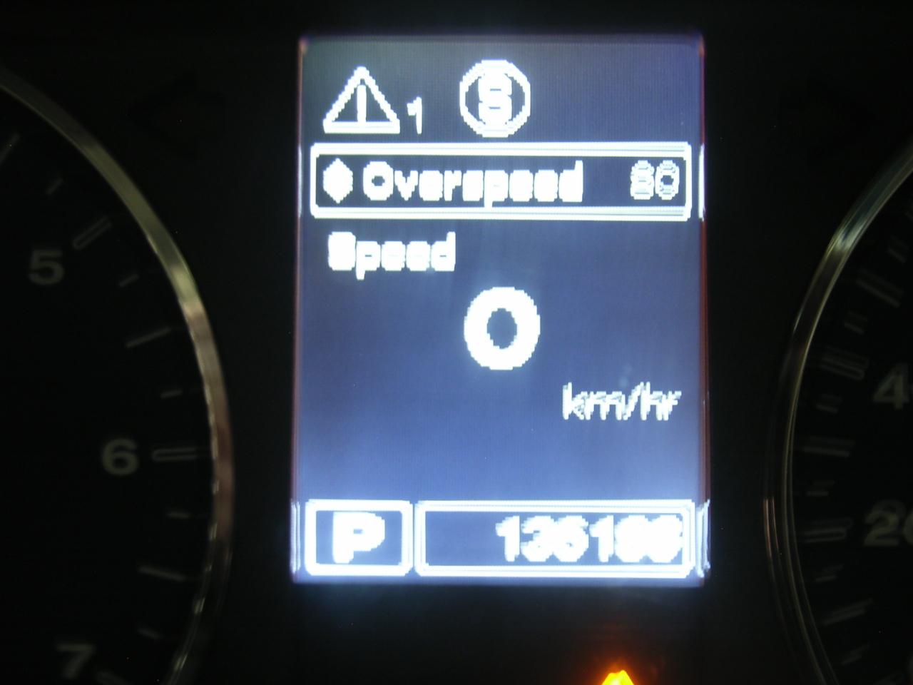

  1. Fixed! was a solenoid. local trans workshop diagnosed it from my description did not look at the car I asked how to identify the B solenoid which in the trans are marked S1 S2 S3 S4 said you need a book (I could not find that information anywhere) and would not elaborate further so I booked the car in.
  2. Well that did not work! P0758 (solenoid B) the solenoids in the transmission are marked S1 S2 S3 does anyone know which one is solenoid B as indicated by the scan tool fault code P0758

  4. just done another scan with Forscan this time it picked up a code P0758 now I can address the problem. thanks to those who replied.

  7. 2008 G6 LPG falcon I have a transmission fault come up on the dash screen (no fault logged with scanner) yellow triangle with exclamation mark says press "SEL" when I press SEL it comes up with a white triangle with an exclamation mark with the numeral 1 beside it. Does anyone know what this means or where I can find the information? Thanks John
