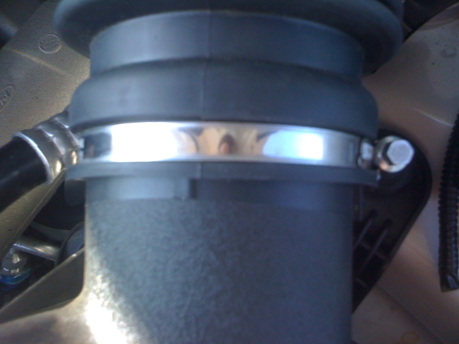

  6. The only hose I found to be at all loose was directly off the back of the airbox. I tightened it and went for a drive but the noise is still there. 310_FSX can you have a look at this hose for me and let me know if it goes over the plastics lugs on the airbox outlet or sits up against them? I have included some pics of mine where you can see th plastic lugs.
  7. I have checked over all hoses and fittings and all seems fine. I do like the way it sounds but dont want to cause any damage to the car! Might have to get the dealer to check it out.
