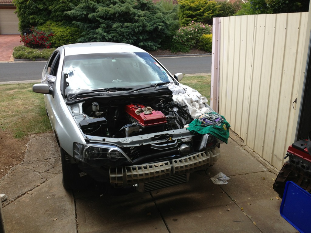

Got it two days ago and f*ck me has it totally f*cked any chance of finishing my engine change over in a timely matter all I have to do is fit the fuel rail and top half of the inlet manifold coils and intake piping not happening till friday easy Xbox360 add KeddyXR6T *BOOM headshot*

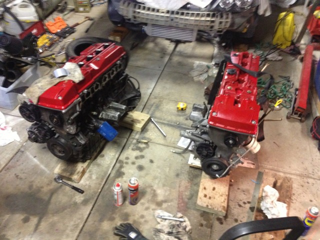

For anyone doing the swap Cheers Ralph didn't use the second knock sensor and haven't had a issue Alternator brackets are different if you use the BA alternator you will have to switch over the rear bracket and run the shorter BA acc belt everything else was fine. Two funny things but the BA flywheel teeth is bolted and flanged where BF flywheel is strip welded & fasteners and fitting's on the BA motor have a zinc/alloy finish to them and BF a chrome/alloy finish
BA to BF 07 long motor change over today in a single car garage on stands + two jacks + engine crane (cash is tight patience is short) wasn't all that bad of a job to be honest refitting the new block took awhile with allot of jacking and packing and did have to switch over the rear alternator mount as BF's mount is wider and dose not fit to the BA alternator so this will mean I will have to run the shorter BA acc belt as well
