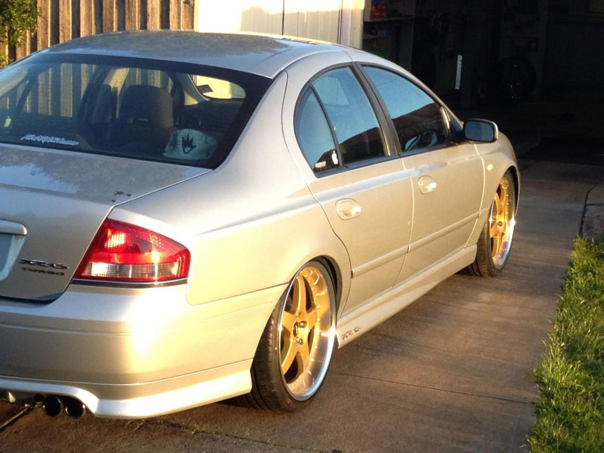

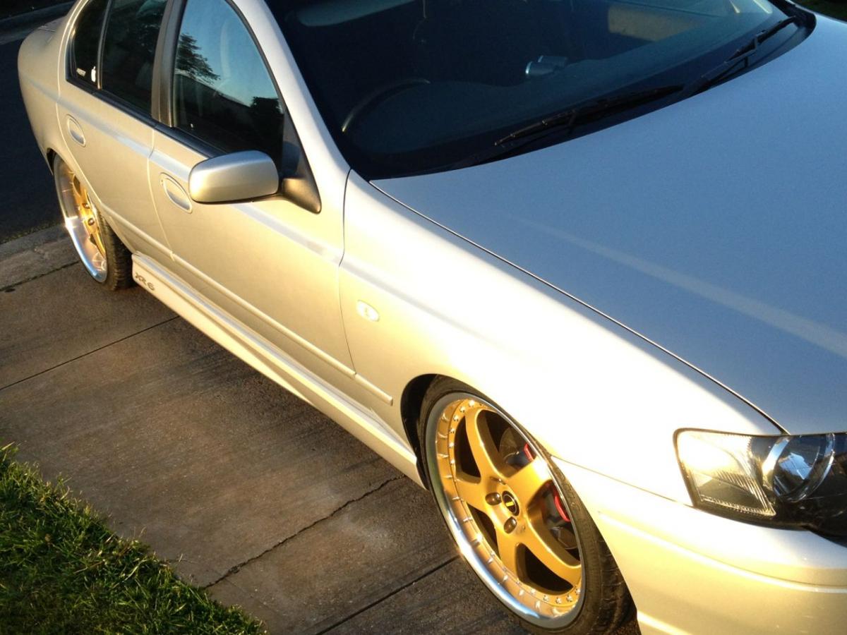

  13. Hey people I have compressed Lovell springs set fairly low love my ride's height but now 70 thou k's later springs an shocks have had it aswell as most of the bushes so ill be replacing it all I found the springs started feeling quite soft about 40 thou k's in the question I have is would I be better off switching to coilovers rather then compressing the springs was using Monroe GTs which I would switch for adjustable koni's by the time I add up koni's new springs + compression around the same price as a set of wholesale suspension coilovers added a pictures of the height any advice would be appreciated
