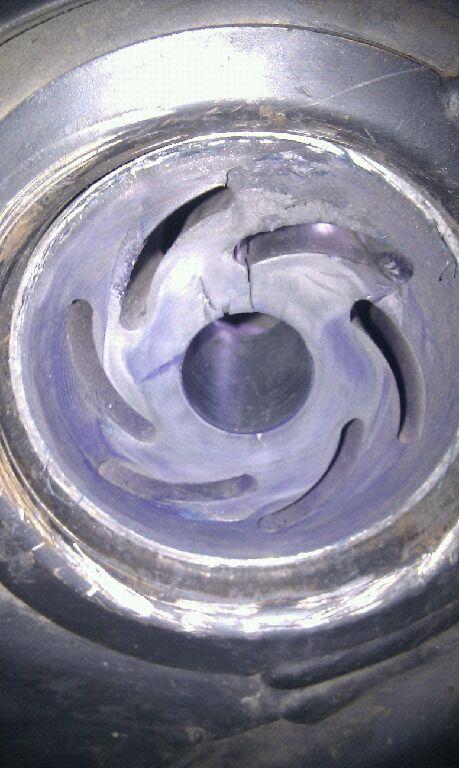

Yeah I think that tramping is a major factor, and I think when accelerating the passenger side diff bush get loaded up on top as well, im only assumeing this as it was clunking badly in forward gears, and not so much in reverse.... -

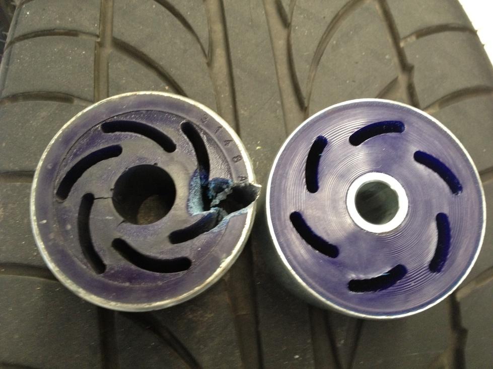

Here is a pic of the old superpro that come out that, and the new one I was just supplied with. The voids on the new one are alot different, it looks alot more solid. also, the bolts that went through the bushes were slightly bent, id recomend chaning these at the same time, the excessive movement from the sloppy bushes must put extra stress on these bolts... -

Hi, I just had the same superpro bush fail, side diff mount on the passenger side. Bush was installed 12 months ago and car has travelled 10,000 kms. Bush was replaced under warranty with no hassles. I dont think installation was an issue. wholesale suspension seem to have a decent name on here the new bushes have different helical cut outs (much smaller, with less overlap) they look alot more solid. so possibly fulcrum had issues with these bushes and modified the design... -
