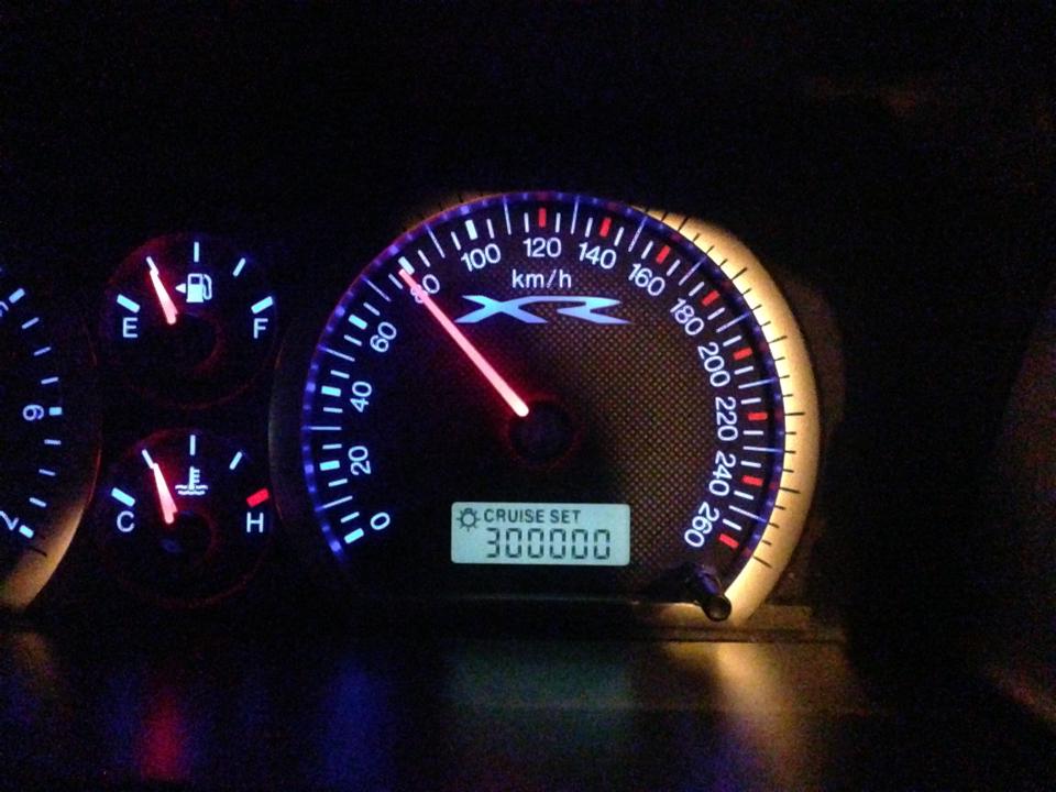

  22. Just a random topic But I've got the series 2 bf xr6 turbo roughly oct 07 build my kms is about 1000kms off 300,000km is there anyone out there that's achieved this milestone yet
  23. I'm ringing around to get quotes for future refs, this quote which was the cheapest was Midways but ill try midland autos, I'm sure they do a good job the problem is the cars gotta have such a low downtime. But the work that needs to be down which is included in the price is ofcourse 1, Remove and Refit new diff bushes - I'm supplying superpro centre bush and ford supply the standard outter bushes, I want a mix of poly and rubber 2, Re-seal my new diff after it was installed incorrectly by NUFORD WANGARA since been installed nov 11 3, Replace the lower control arm bushes both sides 4, Replace left hand tie rod arm and end 5, Check the upper right hand side ball joint for the suspension p.s. Car was purchased on Jan 08 with 5000kms on the dial @ $30895 outright from Nuford Wangara Year to date of 2/5/2013 I'm sitting on 295,224kms, I noticed that I put 299,000kms on the first post which is incorrect car performs very well but then again it has the FG xr6 turbo engine in it that was installed by me in March 2012
