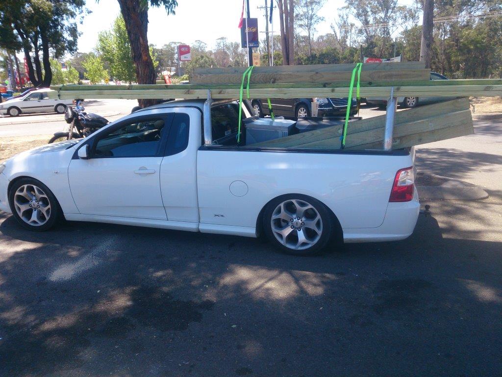

cant really see it but theres 500kg of sleepers on this load plus all the other timbers and other stuff- total weight is ummm a bit more than that (cough 900kg cough). those timbers on the racks run the full width of the racks no skids with this load -
