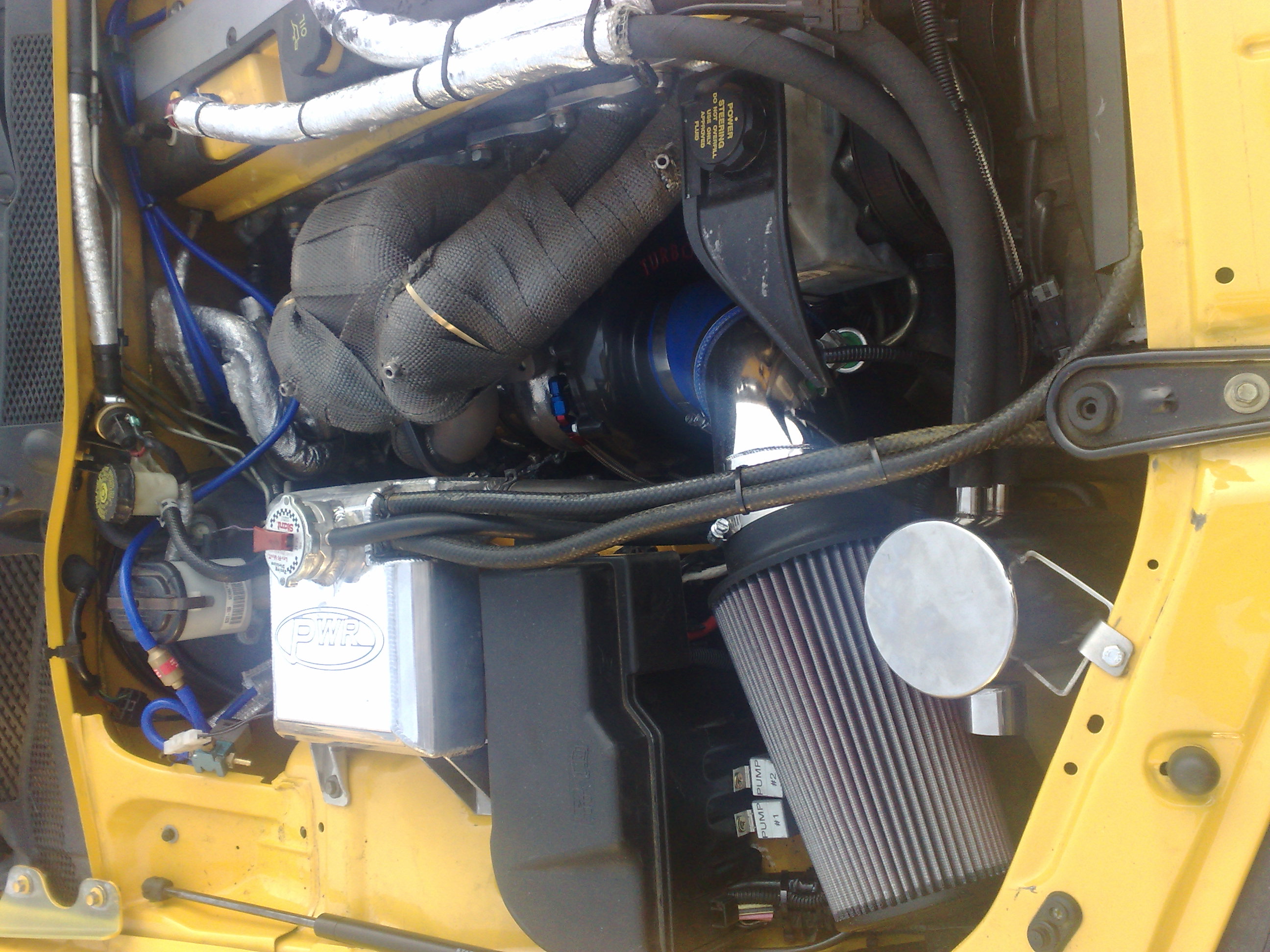

One between the turbo and the intercooler and one between the intercooler and the Inlet manifold. Was told to do so by Tubo supplies in Townsville . Seems to work okay . see photos one under each guard . -

Just picked it up after 3 stinking months at the shop. New 850 Turbonetics Turbo from John Patrick in Townsville and new Intercooler from Process west. Now have 2 BOVs one on either side of the Intercooler , heaps of heatwrap ,and 2 XA GT scoops in the bonnetfor cooling under the bonnet.. Having 18 by 8.5 and 18 by 10 Enkei GTC and semislicks fitted tomorrow. Will have to save up and go and see Mal Wood for Gearbox, tailshaft and Diff. On Redcliffe Dyno , there were a few problems before . They have changed owners ? Am looking at competition seats and rollcage can any one help on that as in who to see ? What are the rules on roadworthy and Rollcages ?? -
