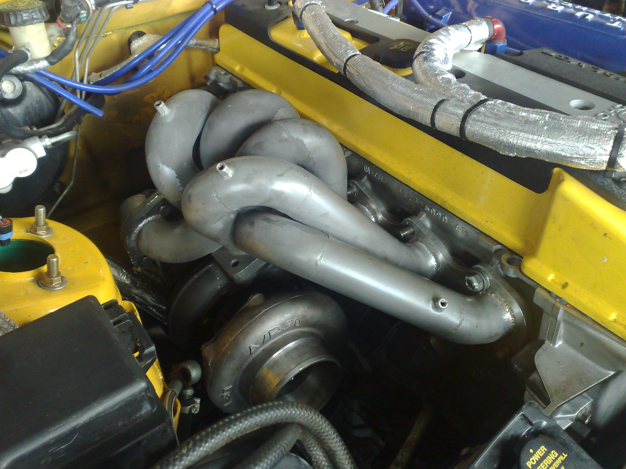

  3. Have changed the Manifold to a 6 Boost , GT4294 turbo and dual Tial 38 mill wastegates. So fat 498 RWKW at 22 PSI on 98 and 543 WRKW at 25 PSI on E85 on Kyles dyno. Power delivery is so much smoother and we expect a lot more power now we have a 200 litre of E85 to play with on the dyno. next roll cage and race seat

  11. Have an Atomic motor with Fat rods, Hi mass Balancer ,Main girgle support ,Atomic Anti pump up Lifters. Nispro Inlet and exhaust manifolds , 5 inch Dump to 3 inch exhaust. Turbonetics GT850 turbo , 1000cc injectors and heaps more I can not remember
  12. Have changed tuner to Craig at Torque and Tune in Caloundra , and he has got us 525 RWKW on 98 pump. Changed injectors to 1000cc and the rest is tuning. Only trouble now is getting it to the track , as the 285 semislicks are not up to it. Looking to change the exhaust maifold and 850 Turbonetics for a 6Boost setup with twin wastegates and new turbo. The old setup is great power and would suit a daily driver or drag car but on the track it is very hard to get out of the corners without wheel spin. Putting new manifold , wastegates and turbo , then rollcage , better suspension as the tien is not much chop and seats and harness. Then just go Porsche chasing. Any one have a suggestion on a good suspension guy and roll cage ?? . dyno f6.pdfdyno f6.pdf
