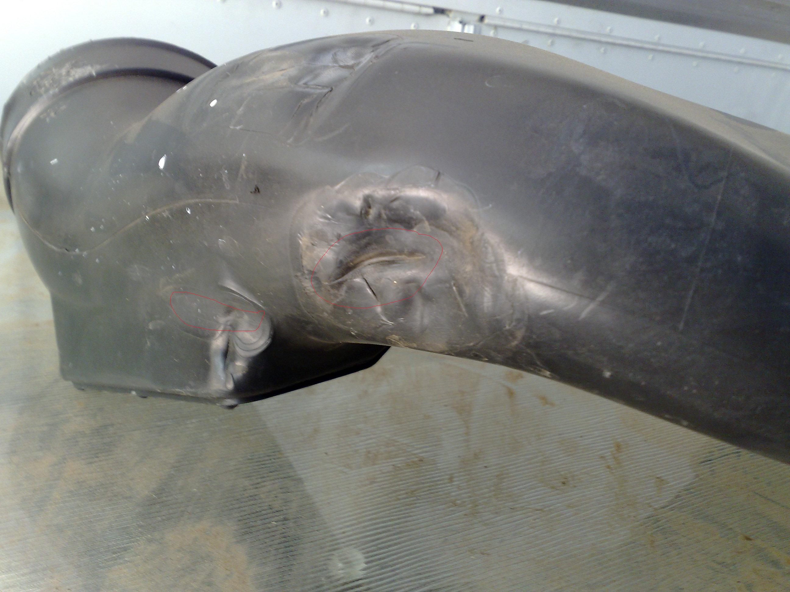

  19. Thanks Benny. I'm not going mad. Yours is in the exact same spot as mine. I think I might have caught mine a bit earlier than you though judging by your pics. Mine looks a bit ugly due to having to mould it back in slightly for clearance. It's not as pliable as it looks either. My only concern now is where it rubs on the cold side of the intercooler tube running up to the throttle body. I'm thinking of putting some soft foam or some other material in between the snorkel and the tube to try and minimise chaff.
  20. I'd be checking your throttle body work. Maybe something is still in there and the butterfly keeps getting stuck. Or maybe it could be the Throttle Position Sensor. Ain't got nothing to do with the clutch or the gearbox mate.
  21. Hey guys, here's a pic of mine. It looks ugly but it's functional and doesn't hit the belt any more. I've circled the positions on the snorkel that the belt has touched and are now clearanced. I've also circled a section at the top of the snorkel that needed doing as well. It was touching the heater pipe that came out of the thermostat housing.

  24. Sorry guys, maybe I didn't explain it properly. At rest everything looks fine. Under hard acceleration the engine will torque over to one side. When you step off the loud pedal the belt will get a bit of a whip in it as the engine drops off revs. This whip is what will be hitting the snorkel if you don't clearance it properly. If you haven't done any clearancing on the snorkel yet, give it a hundred kms or so then look at the side of the snorkel.
  25. Hey guys. Don't want to burst your bubble or anything, but unless you clearance the snorkel to the drive belt it will touch it under accelerationa and leave belt dust and rubber everywhere on the front of the engine. Once you've fitted the snorkel look closely down the side of it and you'll see how close it is to the belt before you even start the car. What you need to do is remove it and get a hot air gun, or maybe a hair drier that puts out some heat, and depress the sections that are close to the belt to give it more clearance. That way you won't have to worry about a belt failure.
