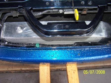

  6. In the intercooler workshop page scroll down to "Bumper Removal". It will tell you how to remove the front bar. It's really easy I just did mine last w/e. The intercooler isn't that hard to remove. If your new one doesn't fit exactly then just get some bits made up. I got two pieces of piping made for mine and it only cost me $45 from nissan welding at yamanto.

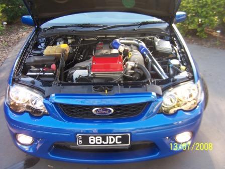

  12. Just finished the install yesterday and hope to be getting it tuned soon. I replaced all the cold side piping, intercooler and intake. Also added an oil catch can. Here are the pics of the result:

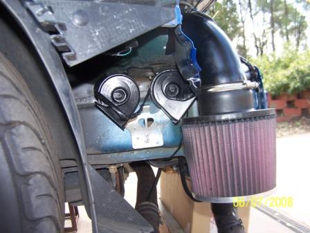

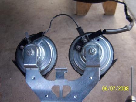

  19. I have taken two pics of the horn. One is of the wires the other is where I relocated it to. Make sure you mount the bracket first before you try to see if it works. I tried the horn when it wasn't mounted (just sitting on the ground) and it hardly made a sound. But then once it was mounted it worked fine.
